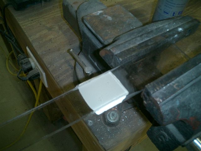

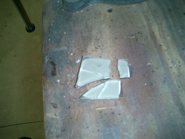

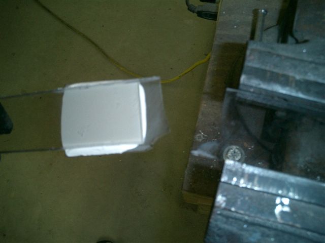

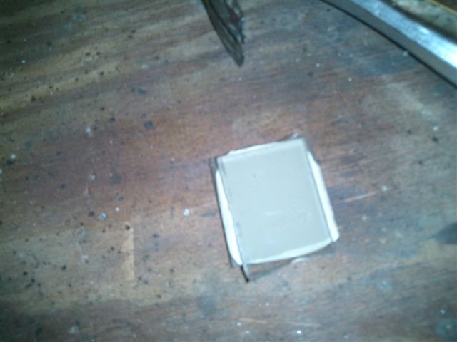

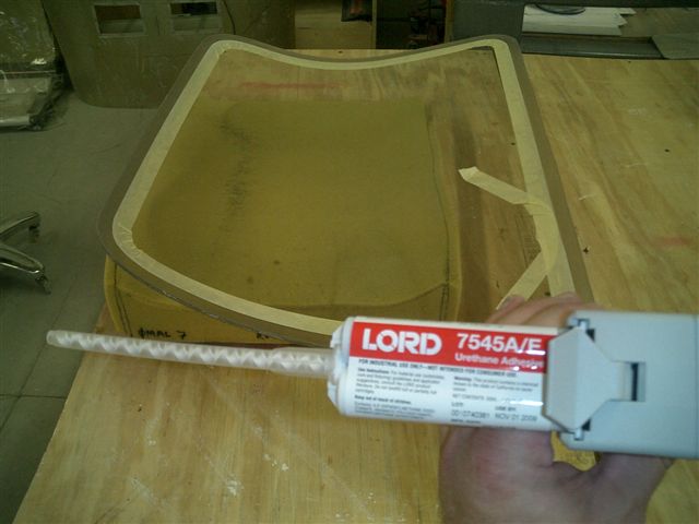

Here is my original write-up that Kelley referred to......

It's been a while and I only used it on the doors so far but I would budget one kit for each side window and probably 2-3 for the windshield just to be safe. Someone else may have a better recollection. I did the side windows with Weldon and I was in such a rush that I forgot to put the spacers in and had the windows much too low so now there is a transition down to them. Really wish I had the Lord stuff for those.

Lord says that a 50ml cartridge will do 4.5 feet at 1/4" bead. I would buy
the 200ML and get 2 of them.
200 ml will do 19 ft. Rear windows are about 6.5 feet circumference fronts a
little more. The Windshield
is about the same as the door windows.
Order 4 extra mixing tips. This is also good for gluing the canopy top to
the fuse at the door
Frame area.
