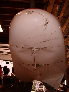

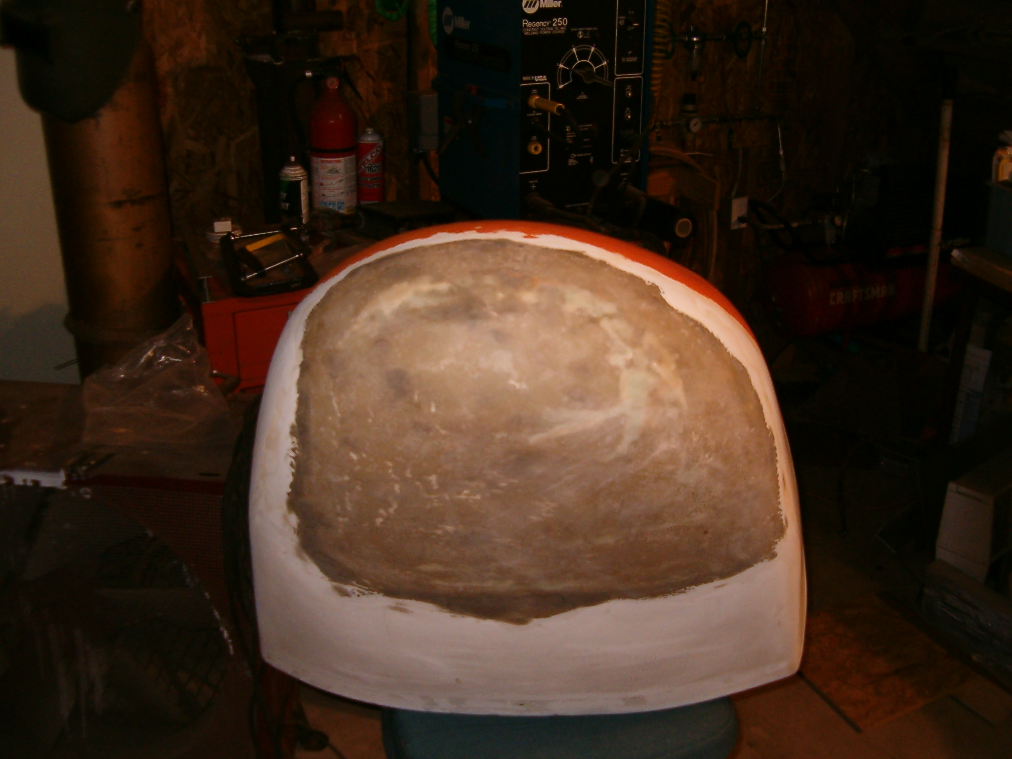

I can help a little on this. Just went through the same thing. I had a freind who helped me. Some may know him from MV 2004 - Bruce Williams (Kitfox). He loves to play with fiberglass. He has built a couple of glass planes. He basically worked on this while I worked on some other stuff.
This is what I ordered from Aircraft Spruce. Not sure if you are talking about just a few small cracks or worse. I deformed mine to where it lost it's original shape. If your job is smaller, may not need all this. We had some material left over. It wasn't cheap and it was a lot of labor (sanding). Think I spent about $100.00 plus sandpaper. New cone was over $400.
Need to epoxy prime, sand smooth to fill and blend and if necessary prime one more time before final finish coats.

Check the before and after pictures to see what I was up against. Hope this was helpful. Got to remember to put thee attactments in backwards order!

After

Before

John, The rule is that you can put epoxy over polyester, but not the other
way around. Prep the area with 220 grit sandpaper tapering out 2" either
side of the crack, use peel ply over the patch so it won't lift the edges
and also to save a lot of time filling the weave for finish.

I was looking at the "BEFORE" picture......It has a "hoop" but yet the nose was damaged.... ( Bickham's )

Just in case there is some confusion. I think we are talking about two different incidents. The damage to my nose cone (before & after pics) was the result of an engine out, off-field landing in a hayfield. Due to bad pilot decision making. It dropped in from 8 -10 feet. Not a simple nose over.
I was lucky nothing hurt me. First thing I checked for while the dust was settling was if a broken piece of tubing was sticking in me somewhere. No hoop would have minimized the damage in my case. I concede that my situation was my own fault. However, engine outs are part of the business. I'm not sure I would want that long piece of tubing down there aimed at my nasal cavity - like a pungee stick.
Not being critical of the large hoop idea. Think it may be good for taxi test. Just sharing my perspective and limited bad experience. To each his own.
Be safe. It just takes a few small wrong decisions to put you in a terrible spot. The first mistake is usually "nothing like that will ever happen to me".
