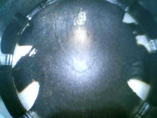

Cylinder #1, Closest to the alternator, 67.46, green dot

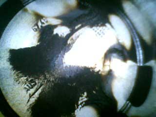

Cylinder #2, Closest to the PTO, 67.45, red dot
Cylinder #2 is hotter… that shoots my theory about the bigger piston running hotter…
Also the top of piston #2 has accumulated a coating of carbon in only 5 hours of operation, while piston #1 is much cleaner. (Photos attached) I have run only AV-2 two-stroke oil in an effort to minimize carbon build up… I’m somewhat disappointed.
