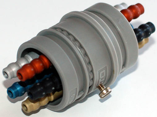

I second Rick's suggestion about a removable panel. They are common on sailplanes. Maintenance is easier and the instruments don't take a beating from riding in the trailer in the plane. The quick disconnect uses O-rings and works well. An electric plug or two, a BNC connector and the panel will pop in and out easily. Glider suppliers carry everything you need to build a panel.
Cumulus-Soaring,com is one supplier. Wingsandwheels.com is another.
Peter
Tubing connectors
http://www.cumulus-soaring.com/winter.htm#Tubing,_Connectors,_and_Miscellaneous
5-way tubing quick disconnect
http://www.cumulus-soaring.com/winter/connector-QD-2.jpg
