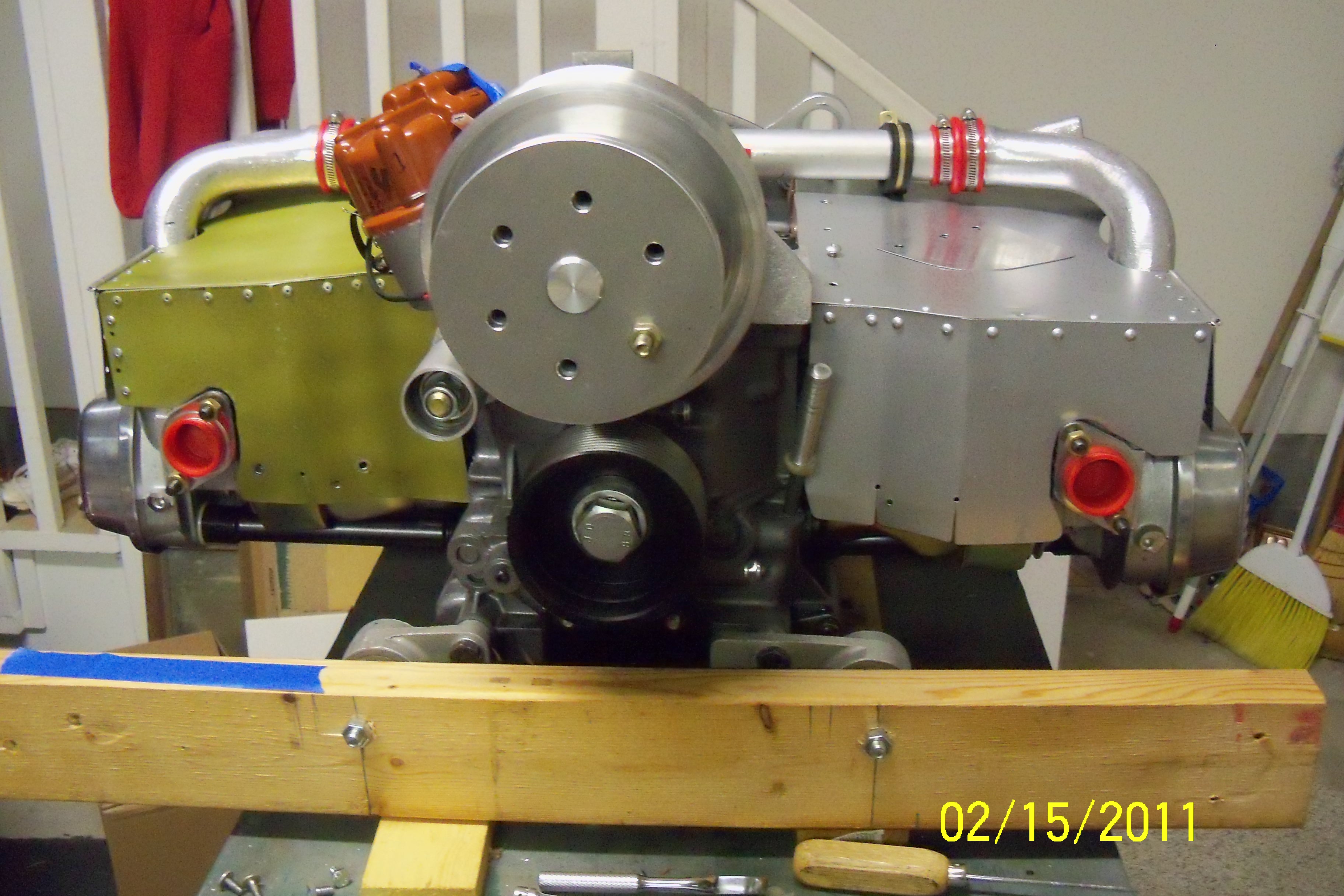

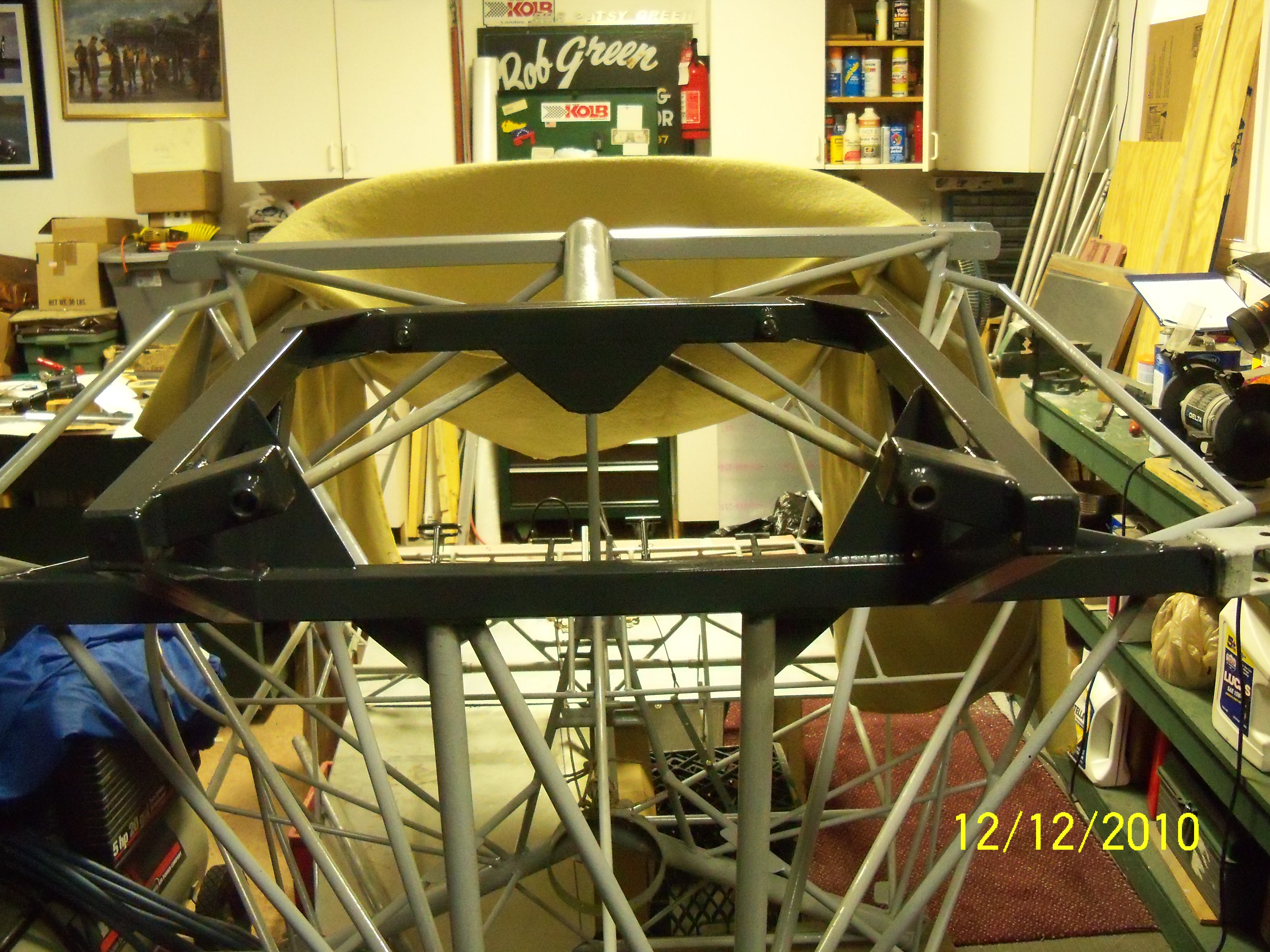

I am going next week to the Kolb Factory to see about getting an exhaust system made up for my 80- 100hp, 2180 c.c. VW, air-cooled, re-drive conversion engine from Great Plains Aviation Supply. My MKIIIX cage already has the engine mount change necessary for this engine and I am hoping that we can come up with something in the way of an exhaust system that will facilitate others using this great engine. I will keep you posted. Thanks Rick N. for pioneering this idea.

Looks great. Seems like the exhaust was one of the few remaining off the shelf parts necessary to have a complete engine package. I installed the stock VW joint, between the J tube/heat exchanger and the rest of in my exhaust because I felt VW must know something. No exhaust pipe cracking so far.
I did talk to the guys at Lord Mounts when I was at Oshkosh last summer and they think there are softer engine mount bushings available. This would be a really good thing to reduce cockpit noise and better isolate engine vibrations. The wide spacing of the mounting bushings should keep the engine from twisting in the mount even with considerably softer bushings. They gave me a name and phone number but I haven't followed up on it and that information isn't available to me till late spring.
I like the cooling scoops. I had forgotten that you had made doors to access the spark plugs, that's a nice touch.
Remember watch you temps on the ground. The engine will over heat quickly when you don't have air flow through the cooling system like you do in the air.

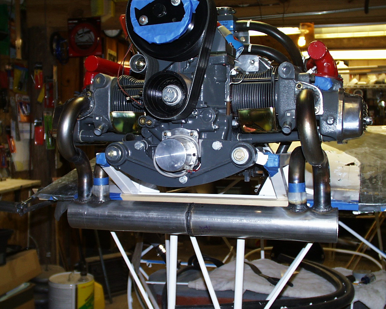

I have been meaning to go to the factory also for the same reason. Please, please have them design an exhaust that stays low and out. We don't need anything higher than the engine. I have already designed my own exhaust but if they make one available that leaves the cylinders and goes down, I will buy it.
Also notice those water cooled heads...
