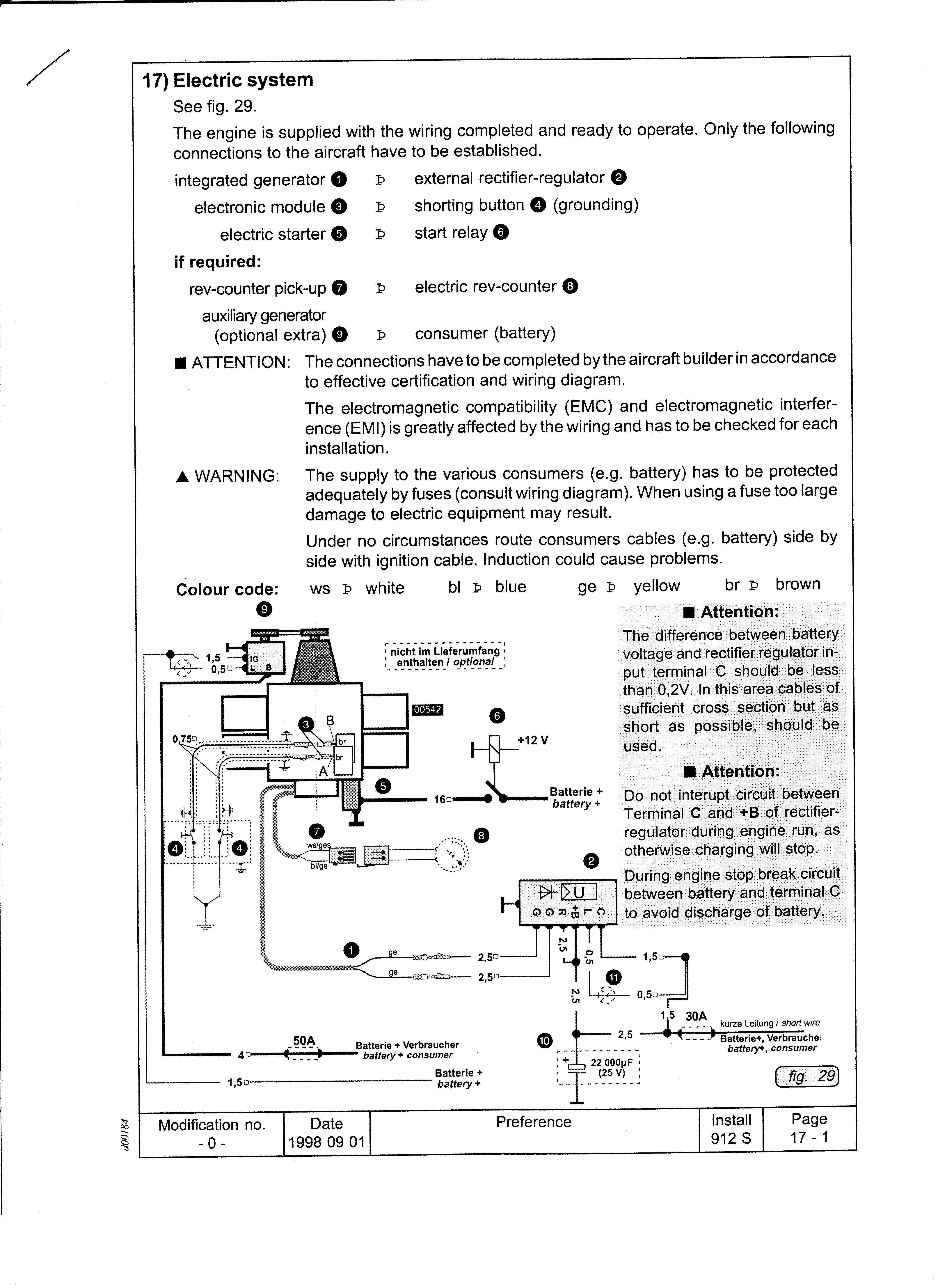

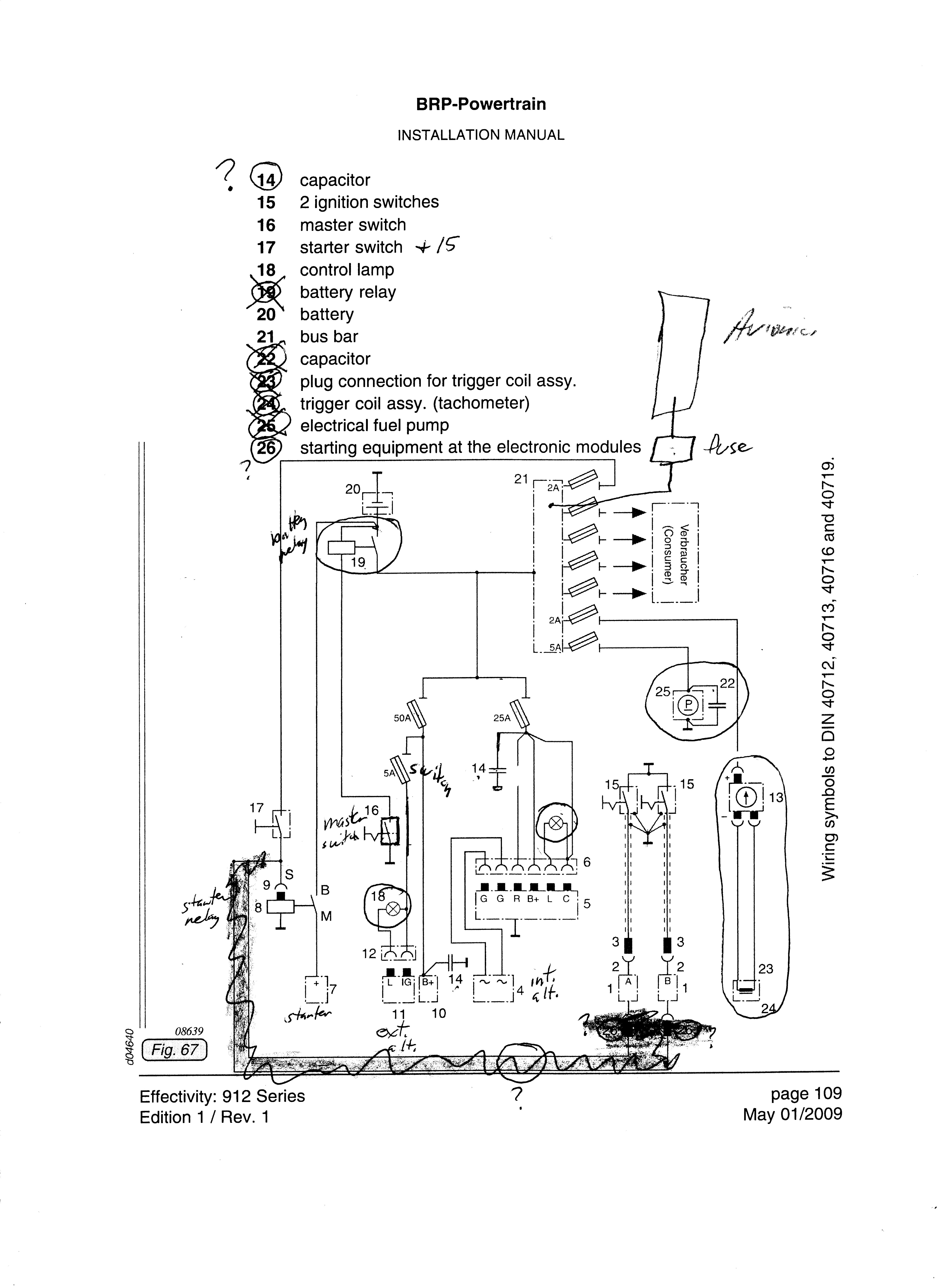

PostPosted: Tue Dec 27, 2011 8:58 pm    Post subject: Relays Reply with quote
Picture #1 is the old system that approximates mine, though there are some
additional C.B. switches and fuses in some lines. #2 is what I would like
to go with. The DPST Master Switch would be replaced with a SPST 5 Amp C.B.
switch and 16 would be a simple Master Switch connected to the battery
relay. Any thoughts, suggestions, or warnings would be appreciated.

PostPosted: Wed Dec 28, 2011 5:07 am    Post subject: Relays Reply with quote
Bill
Okay, the first thing I would do is put those two drawings
in the round-file. These are typical "how things work" illustrations
produced by individuals who are very good at what they do . . .
build engines . . . but are not cogent system integrators.
The drawings are not incorrect . . . but they fall far short
of the details and reasoning processes that should be
applied to the vetting of your electrical system.
Suggest you start with Figure Z-12 . . .
http://www.aeroelectric.com/PPS/Adobe_Architecture_Pdfs/Z12M.pdf
. . . and see where it doesn't meet YOUR design goals
for how the electrical system should function.
If you have no particular wish for an operating feature that
is not addressed by Z-16, then you're good to go. If there
are questions, let's talk about them here on the List. The
externally regulated alternator can be replaced with the
internally regulated alternator depicted in the Rotax drawings.
The 18A PM alternator can replace the 20A standby alternator
depicted in Z-12. But the architecture shown in Z-12 is a
good starting point. I could do a new Z-figure that is seeded
from the Rotax drawing for dual alternators.

PostPosted: Wed Dec 28, 2011 11:54 am    Post subject: Relays Reply with quote
Bob,
Thanks for the response and the schematic. But as I look at it I pinked
out everything that my setup doesn't have and ended up with over half
the diagram pinked out. Your diagram does show me where and how the two
relays (contactors) fit into the system though and that is helpful.
I've also got the rotary ACS starter switch to work with rather then
just a simple switch or push button.
What makes the most sense is adding the battery relay (connected to
battery, master switch, power bus and starter relay) and having the
starter relay connected to battery relay, starter, internal alternator
20 amp capacitor to internal alternator, starter switch, and external
alternator 60 amp fuse to external alternator. Then schematic #2 that I
sent you seems to make the most sense to me.
Any other comments are greatly appreciated. Thanks again.
