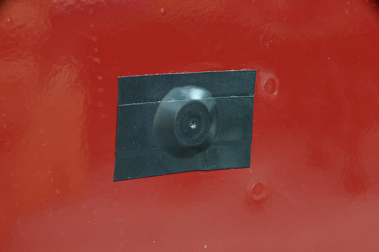

On the static port, it is critical that there be a lip. Whether you used
Van's pop-rivet port or a machined static port, it must not be flush
with the aircraft skin. It needs to stick out about 1/16".

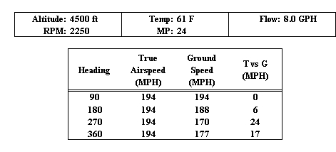

PostPosted: Tue Dec 27, 2011 9:16 pm    Post subject: Dynon Skyview Airspeed Calibration... Reply with quote
At 07:39 PM 12/26/2011 Monday, Matt Dralle wrote:
Dear Listers,
I've been flying the new 10" Dynon Skyview in the RV-6 for a few weeks now and it seems like the airspeed is reading maybe 10mph fast. The GS always reads 10mph or more slower than the True airspeed, no matter which way I fly with respect to the current wind. Looking through the configuration options on the Skyview, I'm not seeing parameters to calibrate the airspeed. If the airspeed were *slow* compared to the GS, I could envision making adjustments to the Pitot tube to get it in better alignment with slipstream. But *fast* is a head scratcher. If there's no electronic configuration parameters to adjust, what do you do? Are there Pitot line "attenuators" like for RF in coax? Wink
Matt
Listers,
Thank you for all the great suggestions on resolving this airspeed issue! I took a look at the static ports on the RV-6 today and found that they are done using a flush head screw with a hole drilled in the center on either side of the fuselage. They do *not* protrude from the side of the plane at all. They are totally flush (see attached picture). Just for fun, I whipped up a couple of quick test deals using a 3/16" washer and some electrical tape. I poked a 1/16" hole in the center of the tape and then put the washer centered over the static ports on both sides of the fuselage (see attached pictures). Then, I went flying on this beautiful December 27 day in California!
I didn't have time to do any real scientific multi-leg testing, but I was amazed that the True Airspeed is now falling in a much more believable range compared to the GPS-derived ground speed. On one cross-country leg, I had an exactly 90 degree crosswind component and the True Airspeed and GPS Ground Speed were tracking exactly the same. Yahoo!
Obviously I need to do some additional, more scientific measurements and probably come up with a slightly more "permanent" washer arrangement, but the early returns are very promising! Smile
Thanks again for all the great feedback!

On the static port...that rivet fix sounds like a great idea. A buddy did it
another way (though I like that rivet idea). My bud used AN-960 washers to
build up the lip on the static ports on his F1 Rocket. In his case, he
actually cut the washer in half, and glued it around the forward half of his
port. He played with thickness until his TAS was very close to his GPS
speeds (multi-leg test). You could probably experiment with -6, -8 and -10
washers, thin and thick washers, sanding or grinding the edges down a bit to
soften the corner, and full or half washers, to see what gets you the
closest. Painting it afterwards could have a slight impact too, so consider
that as well.

Listers,
I went flying tonight in the RV-6 around sunset and took some airspeed numbers flying the four points of the compass. I let each direction normalize for about 2 minutes before taking the readings. I've still got my little black-tape washer deals on the static ports that I detailed in a previous email.
Do these numbers make any sense?
I set the altimeter to 30.15 (KLVK ATIS). I compared the Dynon altitude with the Garmin 696 GPS altitude. The Dynon was high by 100 ft. I used the Dynon altitude adjustment to set it to match the GPS (-100ft). The readings above were after this adjustment.

I think one can calculate from the GPS numbers that you had a 14 MPH (approx) wind from the WNW and you were doing 182 TAS. Your IAS would appear to be 12 MPH too high.
