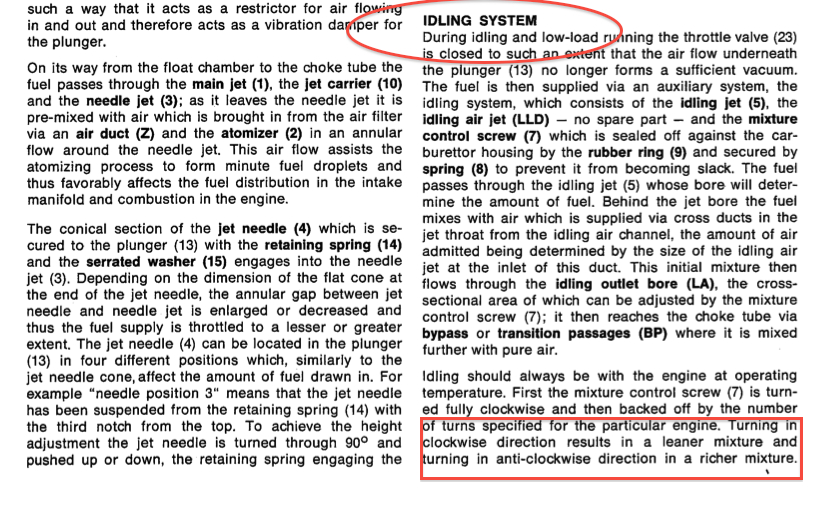

There seems to be a difference of opion here. My jabiru has a model 64 carb
and turning the mixture screw out will let more air (thus a leaner mixture)
and in makes the mixture richer.
See page 17 of the Bing manual
Tex

Tex,
You are partly right. The very early Jabiru engines had the Bing 64. I was not aware there were any of those still flying.
The reference you made from the Bing Manual must be about the Bing 54 carbs, which indeed does operate the way you describe. In the attached excerpt from the manual on Bing 64, it clearly states that turning the idle mixture screw ccw (anit-clockwise) richens the idle mixture. This is the same on all of Bing's CV carbs including the Bing 64 and 94 series.
