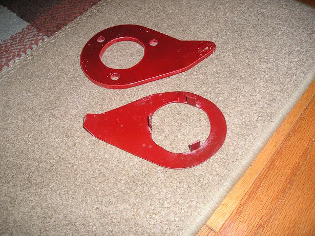

I need to adjust the fan belt on my 447 and need a $20 plus S&H fan
holding tool to loosen the bolt. I also must wait for delivery and may
miss the few remaining flying days before the deep freeze and snow
drifts bring it to an end. Has anyone devised a homemade tool to hold
the fan? If so I'd sure appreciate knowing how you did it.

I made my own from 1/16 steel, with an arm to engage the housing and 3 tabs to hold the fan. Also made a tool to hold the flywheel from 1/4 aluminum. I am trying to attach a photo, but it may not work (never been successful in the past.
