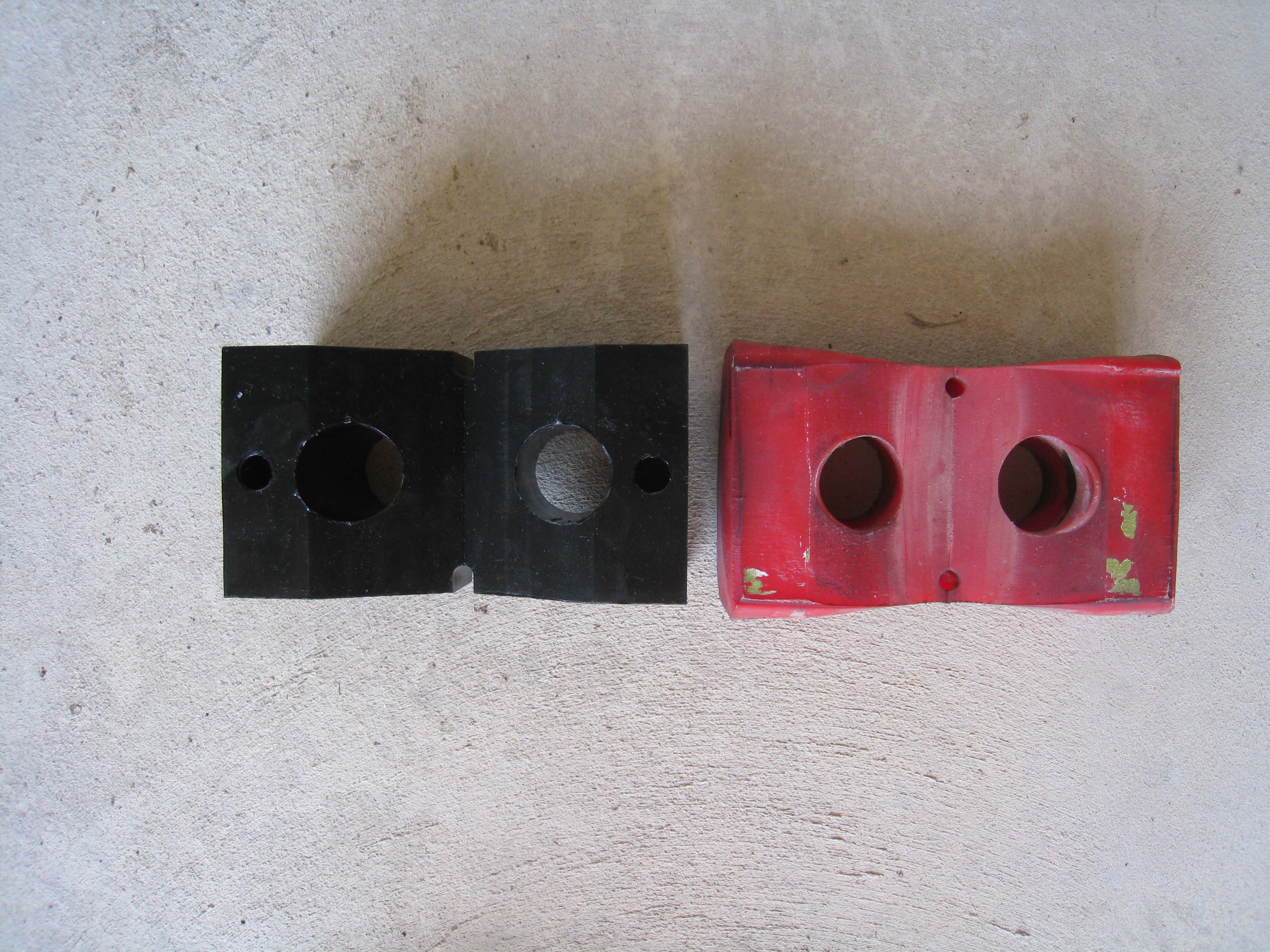

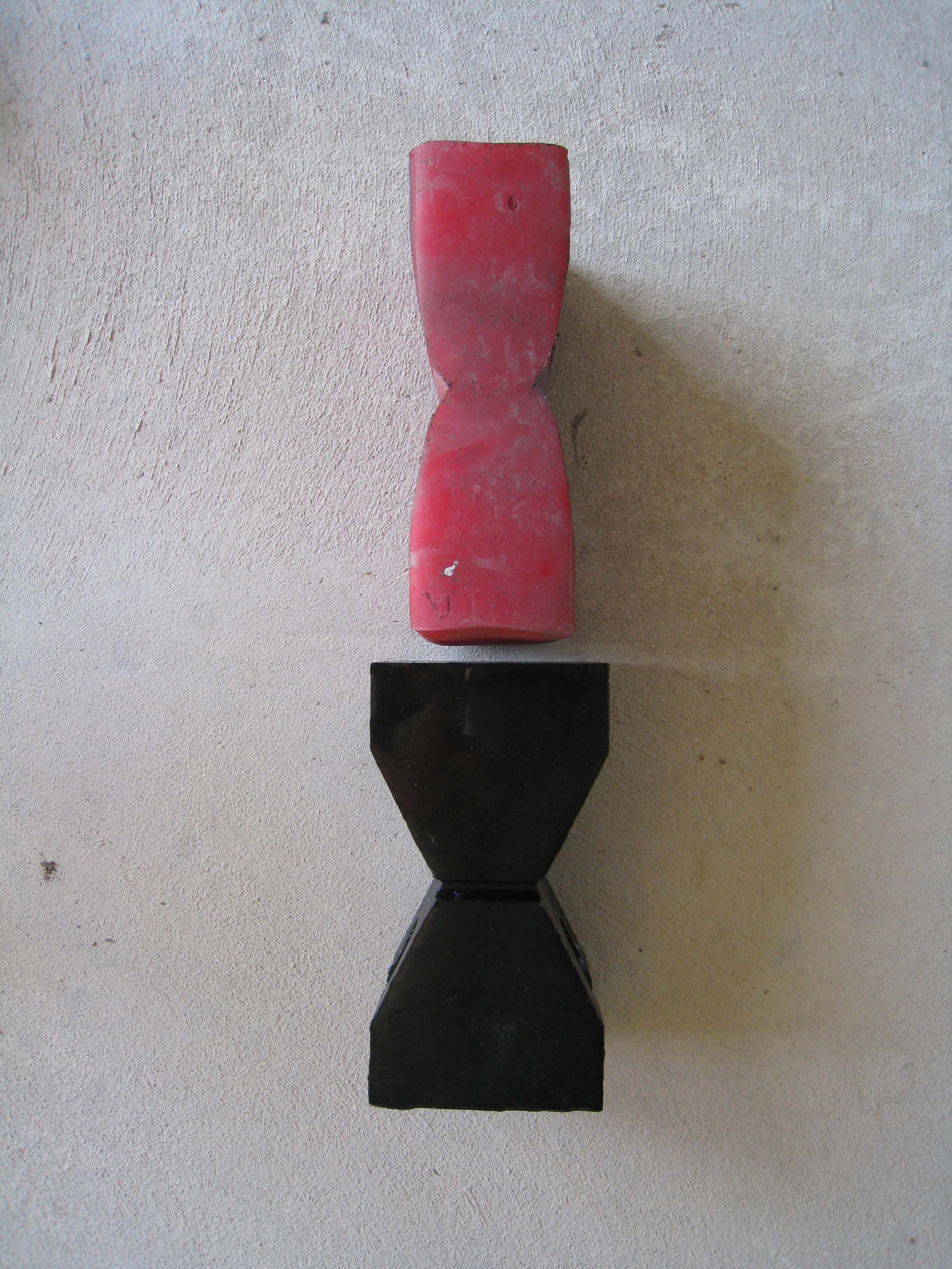

I had the original red rubber block - the one that had the mod in which
you added a ply spacer and cut the vee's. After 50+ days of 100 deg F
heat this summer I noticed the aircraft was sitting very low and sure
enough the shock block was very squished and needed replacing - did good
for ten years though. Replacement was pretty straightforward and a lot
easier than I thought. I'm attaching some photos of the old block next
to the new which I thought were quite funny. The aircraft sits back up
where it should now.
