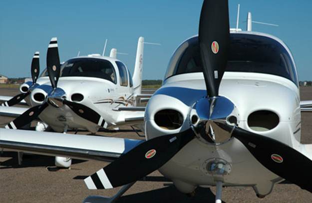

Another option is placing light in the lower cowl like Cirrus uses. I think there is a -10 builder with light(s) there.
[img]cid:C8D8C7BCB3354979A48A5CAE6C8DA813(at)pascalPC[/img]
