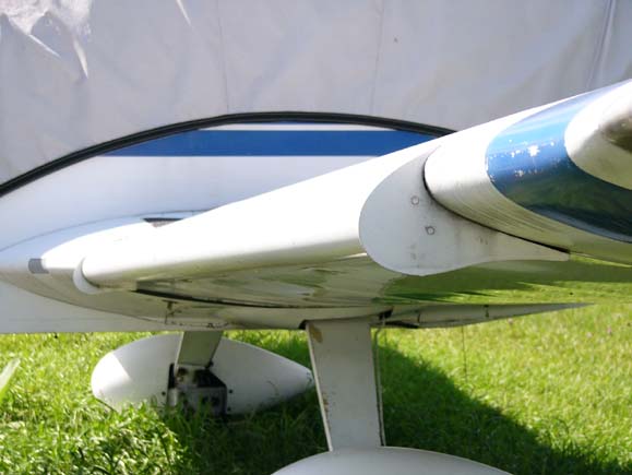

The first pic is the AA1 with a drooped leading edge.
The second pic is the Grumman airfoil (64-415 Mod) rotated +1 degree compared to a Clark Y at 14% thickness.
I'd say, that for all practical purposes, the behavior of a Clark Y is about the same as the airfoil used on a Grumman.
