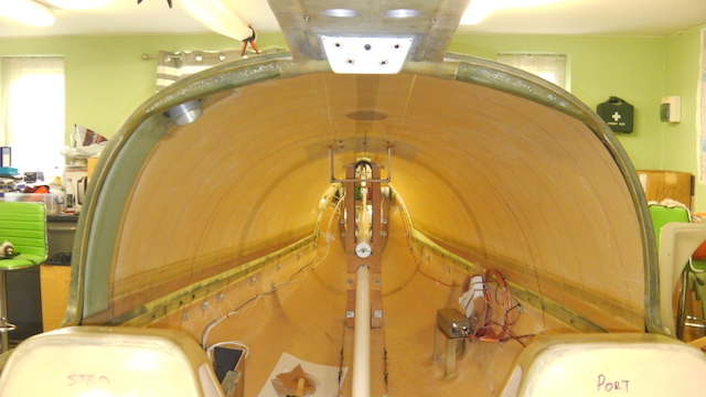

PostPosted: Mon Nov 21, 2016 1:08 pm    Post subject: Dynon AHAHRS question Reply with quote
Bob…I’ve located my ADAHRS unit on a shelf just aft of the “D” panel on the stbd side…the shelf pivots and has slot which allows for adjustment in two axes…here’s a pix…Fred

PostPosted: Mon Nov 21, 2016 1:18 pm    Post subject: Dynon AHAHRS question Reply with quote
I put mine in the roof between the seats pic to follow.  I havent flown yet so cant tell whether it works or not.

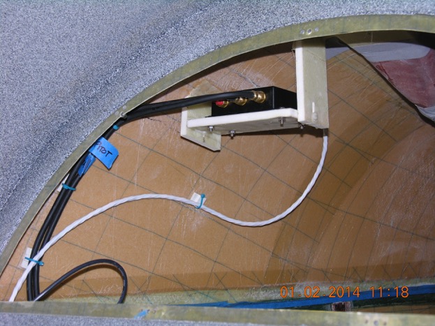

PostPosted: Tue Nov 22, 2016 5:56 am    Post subject: Re: Dynon AHAHRS question Reply with quote
I too have mounted mine just behind the D panel. As per Dynons instructions within 1 degree of.............cant remember now but heres mine.
Made a box for my main and back up ADAHR's to sit on top of each other
 Filesize:  177.74 KB
 Viewed:  14969 Time(s)
