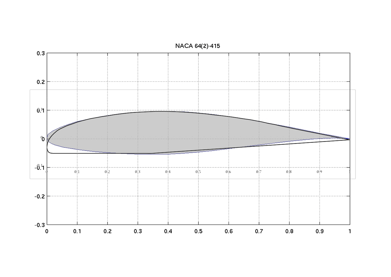

I was able to plot out the Grumman airfoil from the trace that Bob Hodo sent. The really fucked up a good design.
NACA 64-415
6 series airfoil
4 = minimum pressure at 40% chord
4 = .4 coefficient of lift
15 = maximum thickness at 15% of chord length.
What I measured.
- not even close to a 6 series
- minimum pressure at 34.15% chord
- lift coefficient TBD
- maximum thickness at 14% of chord.
The original airfoil leading edge was pooched out and rounded and brought all the way down to the bottom of the wing. The larger flap on the Tiger/Cheetah effectively makes the airfoil no longer anywhere near a 6 series (not to mention the round nose). The flap makes the upper surface reflexed when even with the bottom angle.
Still looking for an airfoil that is even close.
Gary

PostPosted: Fri Dec 09, 2011 11:35 am    Post subject: Airfoil Reply with quote
Andrew,
Realistically, it would be cost prohibitive to change your wings.  Unless a miracle occurs and I become independently wealthy, I'm not going to be able to afford to change the wings. I would love to. I would also love to build a full scale composite de Havilland Mosquito. That won't happen either.
Here are the steps:
ʉۢ keep in mind, this is if I do it. If Kevin Lancaster did it as a variant to his type certificate, it would still be expensive, but it wouldn't take as long.
 1) donor airplane for about 5-10 years.
2) Make up some wings from either aluminum or composite.
• the easiest approach would be to get some original AA1 wings, add the appropriate outboard section/wingtip, flaps ailerons.
3) Find a hungry DER.
• put the plane into Experimental category
4) Come up with really good logic as to why the FAA would think this plane needs a new wing.
5) Create a PSCP to start the STC process
6) Get about 50 flight hours to demonstrate to myself that it's worth the aggravation to continue. (I know it will be only because I want to do it)
7) Write up a report documenting the whole set of flight tests that will need to be demonstrated to the FAA
Cool Submit the PSCP and start all over again with an FAA guy supervising the tests.
There is a lot of chatter about the wing being at the wrong incident. It's all nonsense. You want the wing to be at Max L/D. That has yet to be found with this airfoil, BUT, I think it's around 1-2 degrees AOA. My guess is 1.5 degrees. That puts the plane nose down at 2 degrees. Oil testing shows attached flow pretty much on the entire plane. I need to do some tuft testing in some areas that I question.
The horizontal is also in the right place at 0 degrees. At speed, the horizontal is near 2 degrees down. If what I've found is true, that means the horizontal is near zero lift at speed. You are controlling the entire plane by the horizontal deflection.
I have a quick fix for some of the nose wheel fairing/tire drag. I just need some more money.
I've attached a pic of the Grumman airfoil overlaid on the original designed wing shape. In the previous pics, I extrapolated the angle on the upper and lower surfaces until they intersected. Yesterday, I measured the chord of the wingtip.  The flap is actually longer than the optimum shape of a 64-415 wing.  But, as you can see, with the flap up a few degrees until the bottom is flat, it's a pretty good fit.
