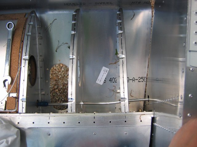

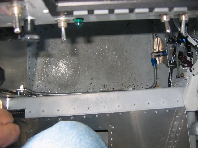

DaveG601XL
Joined: 27 Oct 2006
Posts: 351
Location: Cincinnati, Oh
PostPosted: Fri Dec 09, 2011 4:39 am    Post subject: Re: Solid fuel lines Reply with quote
Same here. 3/8" 3003 aluminum tubing. Although it is not shown in the attached pictures, where the line penetrated a rib or fuselage side skin, I used the silicone tape to provide chafe resistance. I did find a reasonable priced 37 degree flaring tool on E-bay. Flex lines from firewall to engine.
Good luck,
