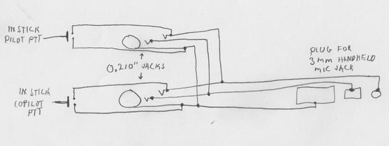

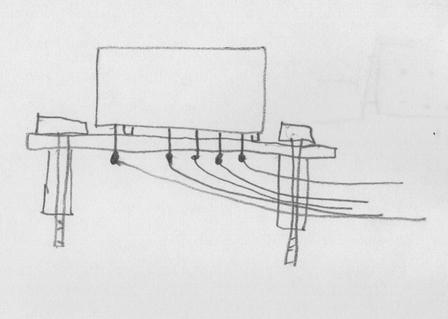

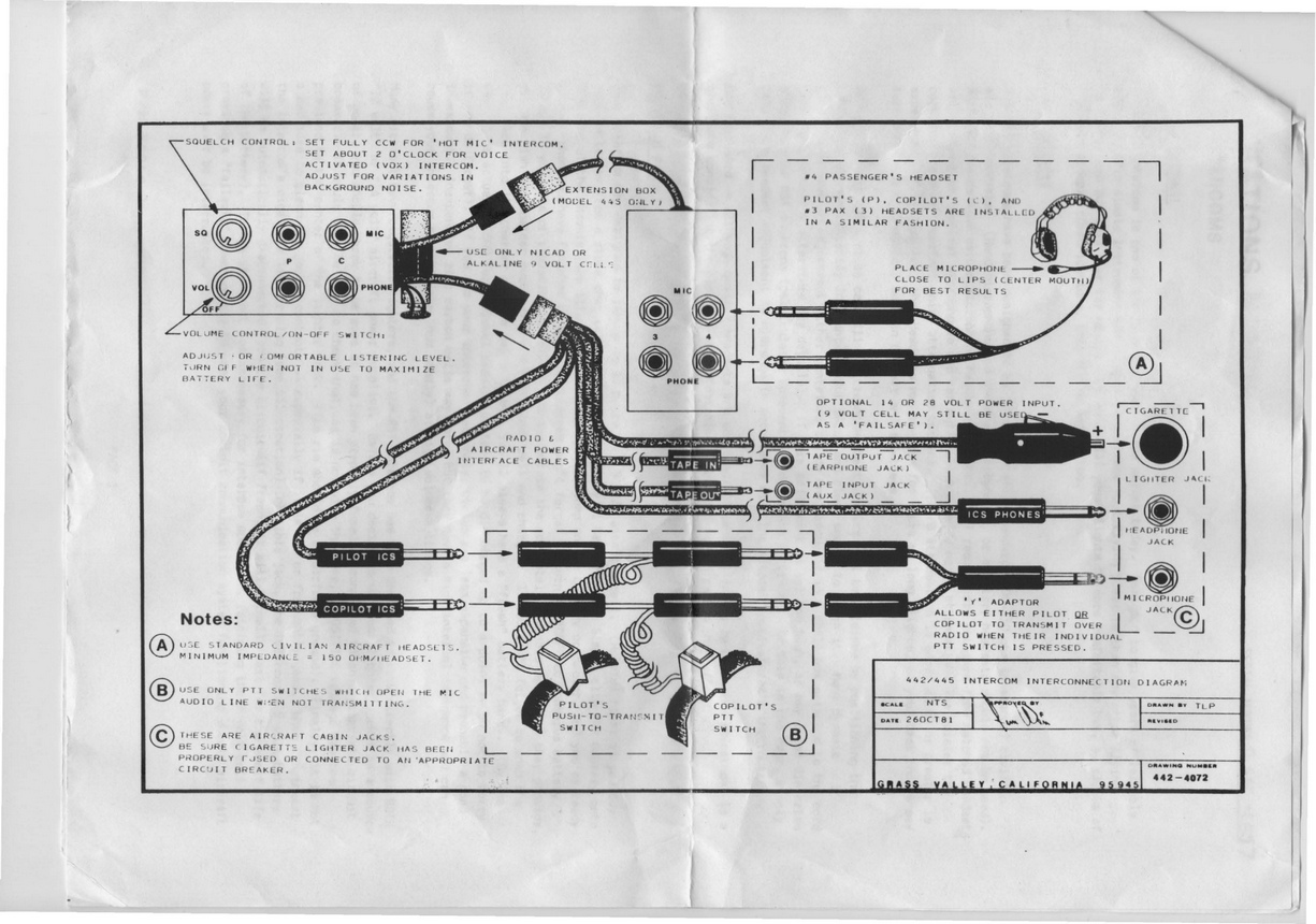

I just got an old RST intercom that I plan to use with a Dynon DX-15 handheld radio. There were a couple stand alone PTT switches with velcro attachments for the buttons that came with the intercom, but I'd rather use my in-stick switches that I'm making.
It looks like I could make a Y adapter with a couple 0.210" jacks and whatever sized plug fits the radio mic jack. I haven't got the radio yet, but the Dynon manual says this jack is 3 mm and the speaker jack is 2.5 mm.
It looks like I could terminate the wires from one .210" jack into the terminals of the other jack, instead of splicing them outside the unit as my drawing shows.
I have some 2-conductor shielded cable. Could I use this and connect the shield to the sleeves?

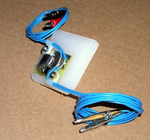

You only need two conductors total . . . a ptt and
ground lead. Shielding is not necessary but shielded
wires can offer some conveniences. My low ohms adapters
[img]cid:7.1.0.9.0.20111120121441.04560db8(at)aeroelectric.com.0[/img]
Use shielded wire for convenience of assembly and
nice 'round' lead wires as opposed to the spiral
lumpiness of a twisted pair.
You can parallel as many PTT buttons as you
wish. You will find that the ground side
of the PTT line shares a ground side of
the mic audio both tied to the shell of
the plug or jack. See Mic jack wiring in
http://www.aeroelectric.com/PPS/Audio/DualCommAudio.pdf

PostPosted: Sun Nov 20, 2011 5:42 pm    Post subject: Re: PTT Y adapter for RST intercom Reply with quote

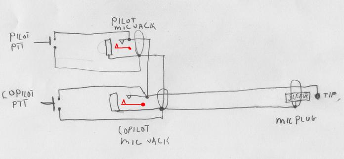

Yes, two conductors only. Shield as one, center wire as the other. I realize now the ring lead didn't connect to anything in my first drawing. I cleaned things up a bit in the reworked drawing below. Is this what you mean?

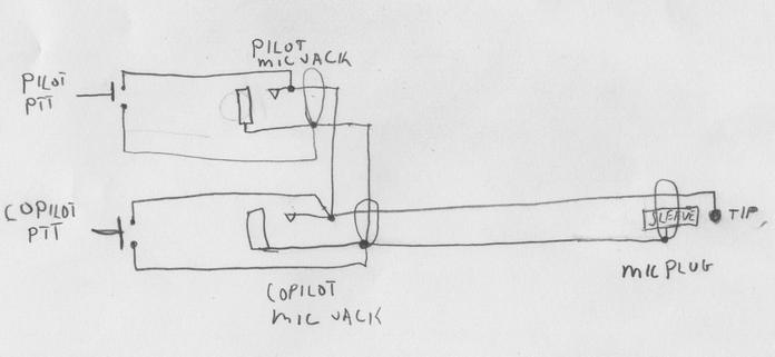

PostPosted: Sun Nov 20, 2011 6:09 pm    Post subject: PTT Y adapter for RST intercom Reply with quote
this what you mean?\
The jacks depicted don't show any microphone wiring . . . are
these jacks wire for mic too? Keep in mind that PTT goes
to the tip connector of the conventional, .205" microphone
plug.

PostPosted: Sun Nov 20, 2011 7:11 pm    Post subject: Re: PTT Y adapter for RST intercom Reply with quote
Do you mean headphone wiring? I left out the headphone wiring, cuz I'd plug my headset mic and phone plugs into the RST intercom box. According to the RST diagram, the lead from this box labeled 'ics phones' would get plugged into the handheld headphone jack.
What I'm trying to replace is the PTT wiring, labeled 'B' in this diagram, so I intended to depict the two PTT switches, the two mic jacks, and the single mic plug. I erased the ring connections in my drawing, leaving just the shell and tip connects for the plugs.
plug.
I also noticed in the micjack.html article the mic jacks have ring terminals that are connected to the pilot and copilot mic hi leads of the 760 radio, while in another drawing of yours, http://www.aeroelectric.com/PPS/Audio/hv1_760vhf.pdf you show these mic jacks with nothing connected to them.

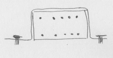

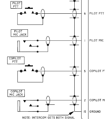

Understand. My comment was based on the fact that microphone
jacks were depicted with only two connections.

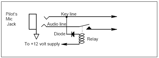

In the drawings I publish . . .
[img]cid:.0[/img]
A microphone jack is drawn with all available connections
so that it is clear which connections are or are not
used. Note that the schematic emulates the position of
the connection along the barrel axis of the plug. The connection
closest to the jack's mounting is the sleeve (mic) and
furthest away is the tip (ptt). In the drawings where
PTT is not connected, PTT functions are addressed
elsewhere as in the snapshot above. If only PTT connections
are used, then mic audio functions have to be addressed
elsewhere.

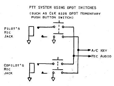

In the excerpt above, look at the position of the
connections along the axis of plug. Those mic jacks
are for audio only. I.e. no hand-held microphones
with PTT switches. PTT functions are managed elsewhere
and only the ring terminal is utilized in the jack.
When you 'erased the ring connections' your schematic
lost clarity.

PostPosted: Mon Nov 21, 2011 7:45 am    Post subject: Re: PTT Y adapter for RST intercom Reply with quote
Understand the importance of making drawings clear, thanks. I added the missing ring terminal, which is left unconnected. In published drawings, the mic jacks leave the tip unconnected, but I went according to your PTT adapter hand drawing. I couldn't find it on your site so posted a renamed copy of it here.
Is my wiring drawing now correct, so that it'll work how I intend it?

PostPosted: Mon Nov 21, 2011 8:35 am    Post subject: PTT Y adapter for RST intercom Reply with quote
That will work . . .

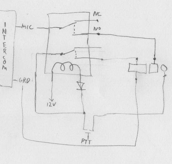

I need to make sure I understand how a PTT circuit works. Lemme start with a panel mount radio. The two I've seen have dedicated terminals labeled 'PTT'. This circuit is normally open, but when the PTT button on the stick is pushed, a ground path is completed. This causes the radio to transmit. In the Microair 760, it looks like pushing either one of the parallel connected PTT buttons would transmit both mics, since they're both connected to the same PTT terminal on the radio. If this is correct, then I've understood it well enough to wire a panel mounted radio.
But I am getting a Dynon DX15 handheld radio and already have an RST 442 intercom to install. I just noticed earlier today you have wiring diagrams for this, http://www.aeroelectric.com/Installation_Data/RST/RST-442.pdf I've disassembled the RST intercom chasis and plan to mount just the squelch and volume controls and the all/pilot toggle switch on the panel and run the mic and phone leads to the permanently mounted mic and phone jacks in the panel.
I plan to connect the mic out wires from the RST chassis behind my panel to the handheld radio, with PTT switches in between them. So I tweaked the design a little to allow for direct wiring instead of using the clunky plugs and jacks supplied with the RST unit. With the system I have drawn, pushing either PTT button would make both mics transmit, right?

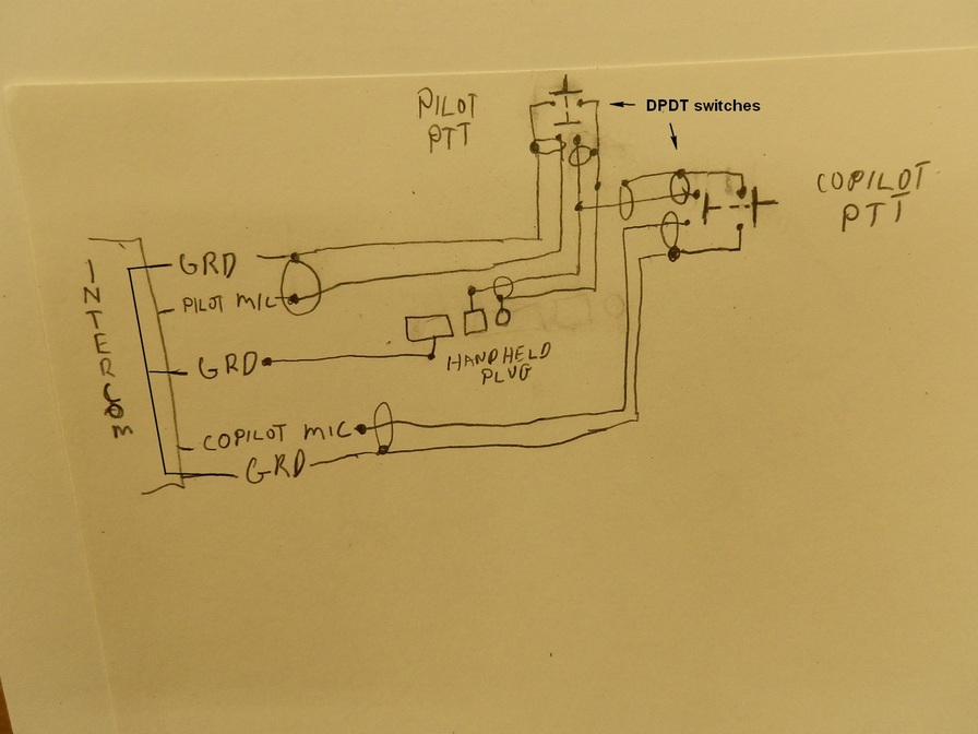

PostPosted: Wed Nov 23, 2011 1:07 pm    Post subject: Re: PTT Y adapter for RST intercom Reply with quote

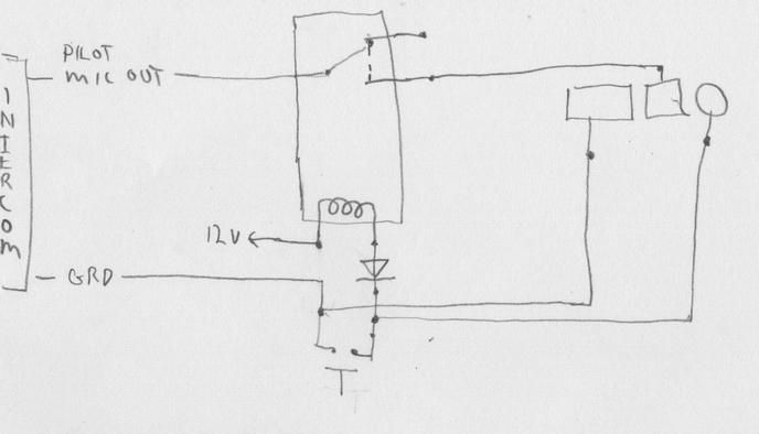

I read this in the RST 442 documentation this morning:
Some push-to-transmit switches are designed only for use with headsets and radios and leave the
microphone audio line (this is the "ring" portion of the microphone plug) connected to the radio even
when the radio is not transmitting. Since some radios ground (disable) the microphone audio in receive
mode, this type of PTT switch is unsuitable for use with an intercom system. If you already have PTT
switches in the aircraft you may wish to try them with your intercom. If, however, you find that you
lose intercom function (microphones are weak, distorted, or dead) when you plug the "PILOT ICS" and
"COPILOT ICS" plugs into the COM radio via these PTT switches you will need to either 1) change to a
model switch which opens the audio line when not transmitting or 2) consult your local radio shop and
have a relay installed to achieve the same effect.

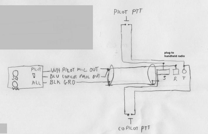

I found out my Dynon DX15 handheld radio sends power to the mic only when transmitting, so my last schematic wouldn't work. They suggested using DPDT switches for the PTT's. Unfortunately, the gatekeeper to the engineer I was corresponding with has cut me off, so I can't get any more answers from them.
I drew what I hope will work for me. I would use 4 pieces of single conductor shielded wire with the braided shield carrying ground current. The intercom has extra ground wires coming out of it, so that's already set. An additional unshielded ground wire would go from the intercom to the shell of the plug to the handheld radio.
How does this look?
BTW, is it common for radios to operate this way?
 Filesize:  134.09 KB
 Viewed:  44236 Time(s)
Dan
Bob McC
Posts: 258
Location: Toronto, ON
PostPosted: Wed Nov 23, 2011 8:54 pm    Post subject: PTT Y adapter for RST intercom Reply with quote
Not quite following you here. You've stated you're using DPDT switches for
the PTT but you've depicted DPST in your sketch???

Hmm...I didn't think if they were or weren't single or double throws. Here's Dynon's quote:
"I took a look at your schematic and I don't think this configuration will work with the DX15..."
He's referring to the earlier 'RST intercom mic out ptt wiring.jpg' diagram.
".. DX15 only sends power to the microphone while it is transmitting.
Even if you were to use a DPDT, I'm not sure what effect having two microphones in parallel will have. It may cause the audio to become distorted if the DX15 cannot provide enough power for both microphones. The headset adapter we sell only has connections for one headset, so we have never tried that configuration. If you were to use two DPDT switches to make sure only one headset mic is connected to the DX15 at a time, I think that will give you the best results."
Below is the drawing in the RST manual that helped me understand what Dynon was saying, so I copied the switch diagram the same. I've reviewed the difference between a DPDT and DPST. Correct me if I'm wrong, but I thought a DPDT functions the same as a DPST when the correct 2 of the 6 contacts are left open.
Semantics aside, would my drawing work?

PostPosted: Thu Nov 24, 2011 8:10 am    Post subject: PTT Y adapter for RST intercom Reply with quote
Unless he sits down to study the RST intercom internal
wiring, he's shooting in the dark.
Do you want both pilot and copilot headsets to access
the DX15 transmit function?

Dynon said "the DX15 only sends power to the mic when it is transmitting". I assume this means it's somehow disabled when receiving. Or is there a concern that the radio can't get power to the headsets? I thought they got power from the intercom.
Weir said "some radios ground (disable) the microphone audio in receive mode, this type of PTT switch is unsuitable for use with an intercom system." I assumed then that the DX15 would have the mic grounded when receiving as the mechanism to cutoff power to it.
I've never read how exactly the RST or any other intercom treats the mic out signal. I thought the VOX switch in the intercom transmitted the mic signal from the pilot's and copilot's mics to both the headsets whenever a certain threshold was reached. From what Weir has written, it sounds like there is no switch or gatekeeper between the intercom and mic out to the radio. Whenever one of the mics overcomes the VOX threshold, the signal goes through the mic out line to the radio.
I also thought the intercom would function fine without being connected to the radio at all. There's power supplied to the intercom and the headphones and mics from the headsets are plugged into it. But Dynon said their radio might not have enough power to supply two headsets in parallel, sounding like the intercom does not supply enough power to the headsets.
I don't know what needs to happen for a radio to transmit the mic signal. I thought engaging the PTT, shorted the tip to the shell, which caused the radio to transmit. Both the PTT button on the side of the handheld and the one in the stick acted the same way. I thought that once this was done, the radio would transmit whatever signal was coming in from the mic.
If the intercom's VOX threshold has been exceeded while the PTT is pushed, the mic signal is sent to the radio and gets transmitted. I don't understand what Dynon means when he says the DX15 sends power to the mic. I know he says it does it only when transmitting, but I don't know what it means. It sounds like power from the radio to the radio's mic jack is needed as well as the signal from the mic out line from the intercom to the radios's mic jack.
I'm sure the workings of a radio mic, its power, grounding and transmitting functions are fairly simple to understand, but I don't have that knowledge. I'd be terribly grateful if you could explain this to me, or where I could get this information.
The thing that bothers me about wiring the PTT with a SPST switch, leaving the mic out line connected to the radio, is that both the designer of the intercom and that of the radio say this is not a good idea and suggested the DPDT solution. How could I test my radio, headsets, and intercom with my current SPST PTT switches? Would I just hook everything up, set the radio to some locally unused frequency and try it out?
While I'm taking flight lessons, I can imagine it would be nice to have that capability for both me and the CFI. Afterwards, it seems unlikely I'd ever need it, except when there'd be another occasion for someone to be taught communication skills.

Your schematic, "RST intercom DPDT PTT with shields.JPG" looks OK to me. The goal is to connect only one mic audio at a time to the handheld radio. Your schematic accomplishes that.
However, I suggest that you use relays as shown on RST dwg 422-3060. Then the mic audio wires can be kept short instead of running them to the control sticks. Short wires are less likely to pick up interference. By using relays, there will be only half as many wires going to the control stick. Double pole relays will allow the hand-held x-mit key to be connected directly to ground instead of through a series diode. Who knows if the handheld transmitter will be keyed with voltage dropped across a diode? The relays will not carry much current. So miniature ones with gold plated contacts are best.
RST drawing 442-4072 was confusing to me at first until I realized that the headsets plug into the intercom and the other plugs and jacks interface the intercom with the radio.

What you say makes sense about using a relay. I drew a couple diagrams, one with a single relay and another with a double relay, but I must be missing something, cuz it looks like both of them have the transmit key connected directly to ground.
I also included another RST drawing. I put a diode in the same place in my drawings, but don't know why it's needed. I'm familiar with using a reversing diode normally put between the two coil leads, which hasn't been included. Why one and not the other?
Another nice thing about using relays in my particular case is that I've already got the spst stick switches made and fitted, just waiting for wires. If I figure this relay thing out, looks like I'll still be able to use them Smile

How about a circuit like this dwg attached?
Joe

Hadn't thought about this before, but I think the PTT relay grounds would go to a/c ground, and the other 4 would go to the radio jack sleeve, right?
I also looked around Digikey.com for the relays. It was hard to match the relays with sockets that are sold separately. I'm browsing through Ebay, which may have something. I suppose I could just go without a socket and glue a strap of 032 aluminum to it. Maybe wrap it in heat shrink afterward, if gluing the case to the strap wouldn't hold up.
Also, everyone says that having two mics connected at the same time could cause problems, but I don't understand why. Does the radio power the mic? I notice that nothing has been mentioned about having the radio connected to two headphones, although I only asked Dynon about the mic. Wouldn't hooking two headphones up possibly cause some problems?

About those diodes in the RST 442-3060 schematic. They block 12 volts from the relay coils from getting into the radio PTT circuit.
Sounds OK to me.

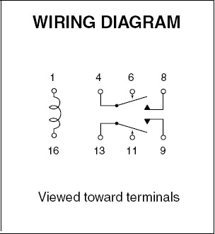

I also wonder about the relay terminal wiring diagram. The attached is typical. If taken literally, if power is applied to the coil, it would move only one of the switches and not the other. No power would mean 4 contacts 6 and 13 contacts 11. With power, either 4 would go to 8, or 13 would go to 9, but not both??
 Filesize:  17.72 KB
 Viewed:  44219 Time(s)
 Filesize:  15.13 KB
