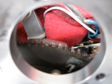

Dear Jabiru Engine owners,
It look as if I have sheared some of the teeth on my flywheel starter gear ( see attached picture). I was having some starting difficulty and voila my starter engaged or disengaged just as the engine was turning over and I pinged some teeth. Anyways The flywheel assembly for a 3300 is part number 4626073 and is in the neighborhood of 600 dollars to replace. I was wondering if anyone out in Jabiruland may have a serviceable/usable part from a damaged engine? I have contacted Jabiru USA and they have to get it from Australia and the factory and don't carry any in stock, moreover if I could save some money with a decent used part I figured I'd try that avenue first.
Thanks for your time and consideration and Happy Thanksgiving to all.

PostPosted: Sun Nov 27, 2011 4:11 pm    Post subject: 3300 Flywheel assembly Reply with quote
Hi Jeff,
I wonder if it is possible (acceptable?) to weld the teeth on your flywheel.  It would be a tricky job, but probably a lot less expensive than buying a new one.  It would also be a lot quicker than any replacement part.
Paul

PostPosted: Mon Nov 28, 2011 5:32 am    Post subject: 3300 Flywheel assembly Reply with quote
Paul:
That is just about impossible.  It is micro welding and would cost big bucks... At least in the NJ area.  The other problem with that is the weld marks would have to be ground to match the pitch of the engaging teeth.  Follow that up with the loss of a safety shear - The teeth on the ring gear are softer than the teeth of the starter.  DUMB... It should be the other way around but the starter manufacture does not want to be responsible of a failure.  And if the ring gear was harder it would also be heavier - Something the builder does not want.  SOOoooo pick a failure point and PAY FOR IT!
The question IS:  Why did it fail?
Barry
