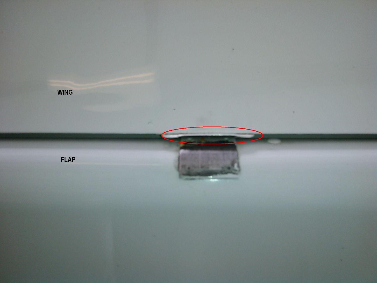

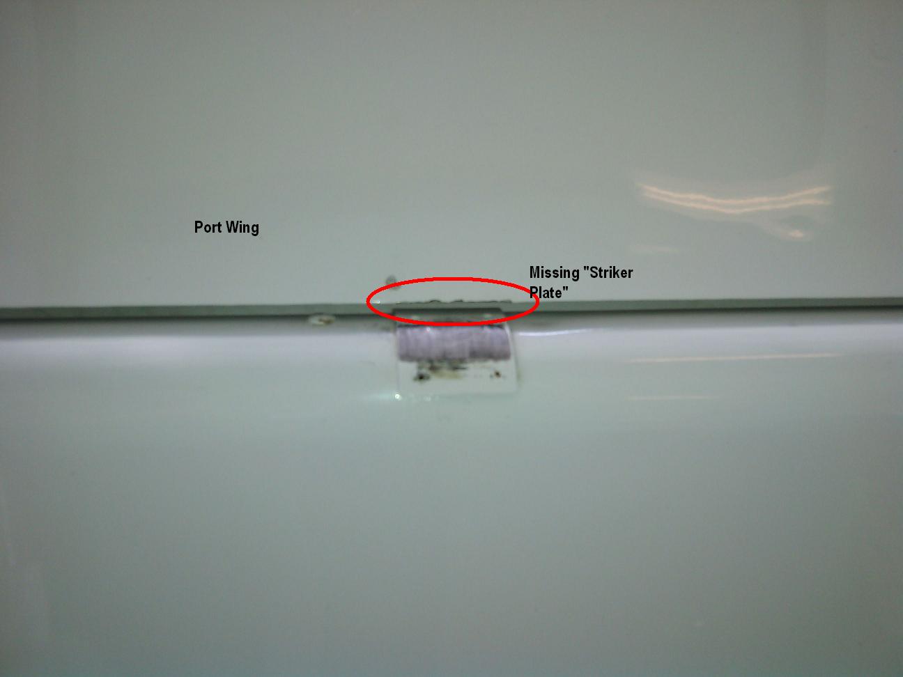

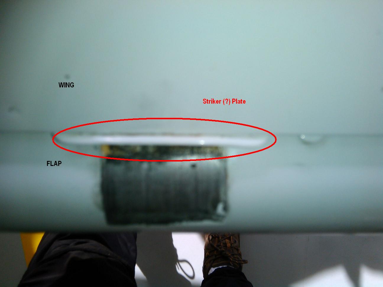

One more question concerning on what appears to be a "flap striker plate?" attached to the wing just forward of ~ mid span on the flap, there is a "rub" surface on the flap just beneath it, does anyone have this part? One of ours is missing., Pics attached

Another picture may be better focus of "striker Plate"

This is pretty common with the original thin skid plate. Get a new plate from Fletcher.
