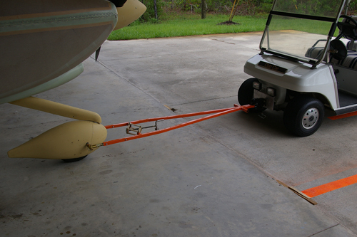

PostPosted: Wed May 24, 2006 8:15 am    Post subject: RV-10 Tow Bar Reply with quote
Here is my setup. It is a Bracket towbar. It works great for me.
