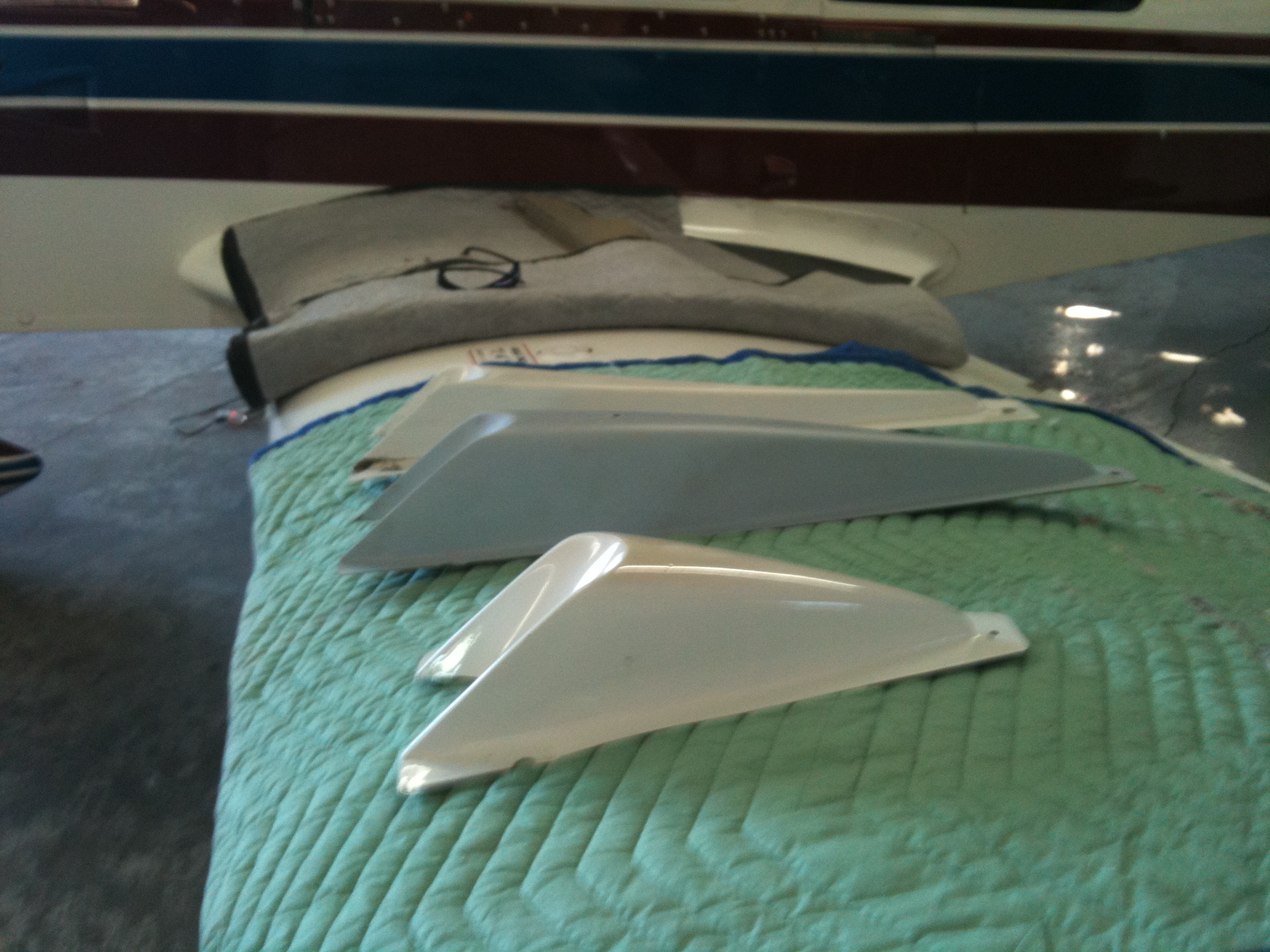

Hi Pete,
I've made 3 different fairings that fit behind the short stack. The short one worked the best. Plus, it fits up snug behind the pipe so it closes the hole created when you cut out the exit ramp. I can have Dave make you one for $100 with shipping. You'll need to do some trial and error on the mounting to get the least drag.
My 77 Cheetah would true out at about 140 knots. That's running over redline. McCauley prop. Stock exhaust. It was light too.  One radio. One GPS. No VOR. But, even with ported and polished cylinders and the HC mod, a loaded Tiger would out climb it.
Lots of drag. I buried the comm antennas, got rid of the VOR antennas and steps.
I restored a 77 Cheetah a few years back. He did everything to that plane. With a New LyCon engine and Sensenich prop, he could true at 142 knots at 2800 RPM with the steps and VOR antennas.
Gary

Hi Pete,
Dave had the first one stick in the tool. It really messed up the tool. He's got it repaired and is planning on making me a couple.
I appreciate you writing. I haven't forgotten.
Gary
