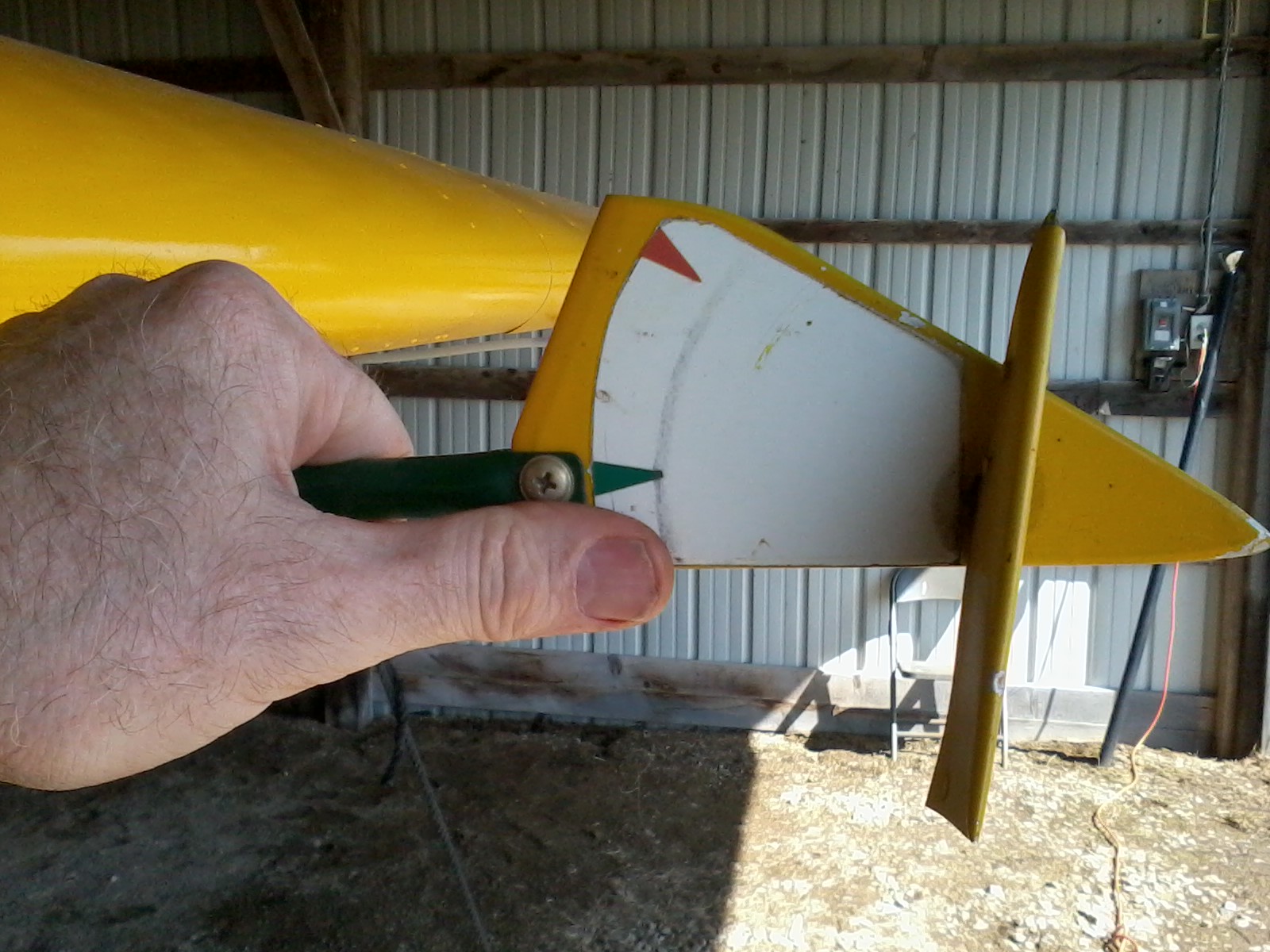

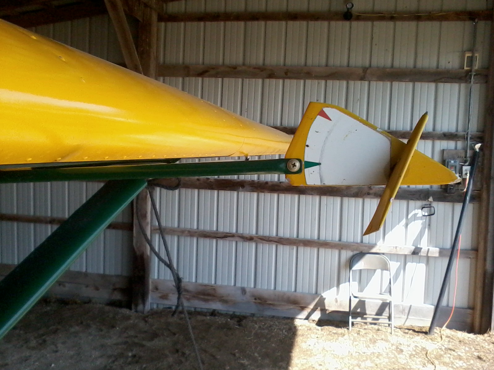

PostPosted: Tue Mar 27, 2012 5:16 pm    Post subject: Re: Angle of attack Reply with quote
this is the indicator i use... not very helpful on landing but very useful in flight when just cruising on the edge.

PostPosted: Sun Apr 01, 2012 4:49 pm    Post subject: Re: Angle of attack Reply with quote
Nice device and picture. Looks like my thumb nail that needs a trim Smile

PostPosted: Sun Apr 01, 2012 6:08 pm    Post subject: Re: Angle of attack Reply with quote
was just trying to give it some scale. i work outside all winter... -20F is a killer on the nails... everything you touch breaks them at the stub... like i said this gizmo is very helpfull . i don't get much buffeting prior to stall... and if you just want to cruse on the edge looking at nature...just set to redline and it works... when landing it is too much out of the line of sight and not worth looking at... you fly to flair and chop power..or giver a little to slow a particularly fast decent.... always too busy to look out side window . you could almost place a protractor on the comp screen to check aoa.... some where asking at ??? deg... level flight is always at green line .. full stall happens at red..
