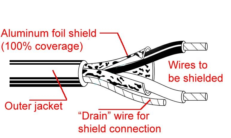

What kind of wire was supplied with your strobes? If
it's foil shield, then there will be a bare 'drain
wire' included in the makeup over the shield. You
ground the shield by putting a terminal on this wire.
[img]cid:.0[/img]

PostPosted: Fri Nov 18, 2011 12:33 am    Post subject: Re: earth shield earthing Reply with quote
Hi Bob
Yes: that's the one:
http://www.aeroelectric.com/articles/shldwire/shldwire.html
Many thanks
