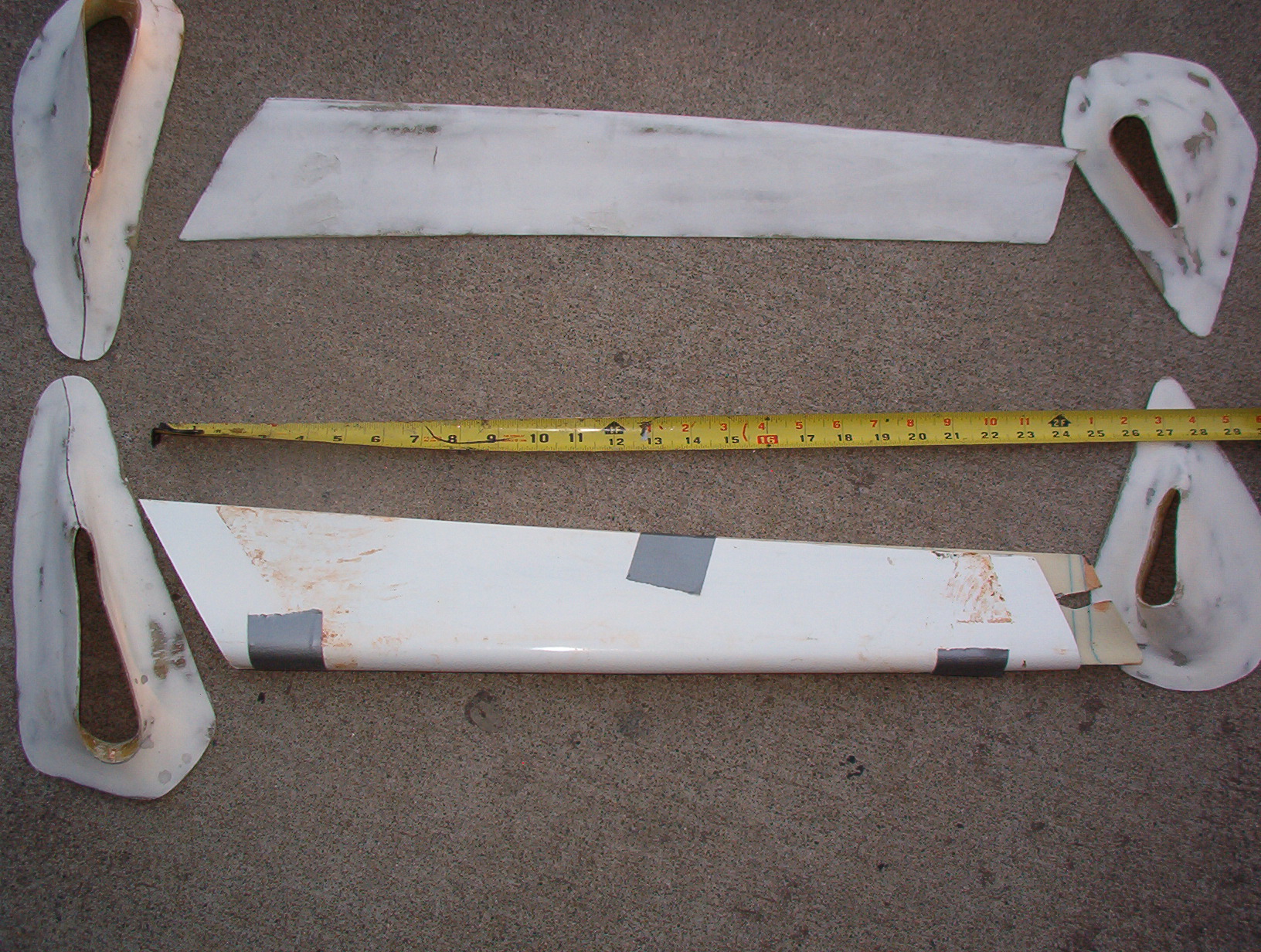

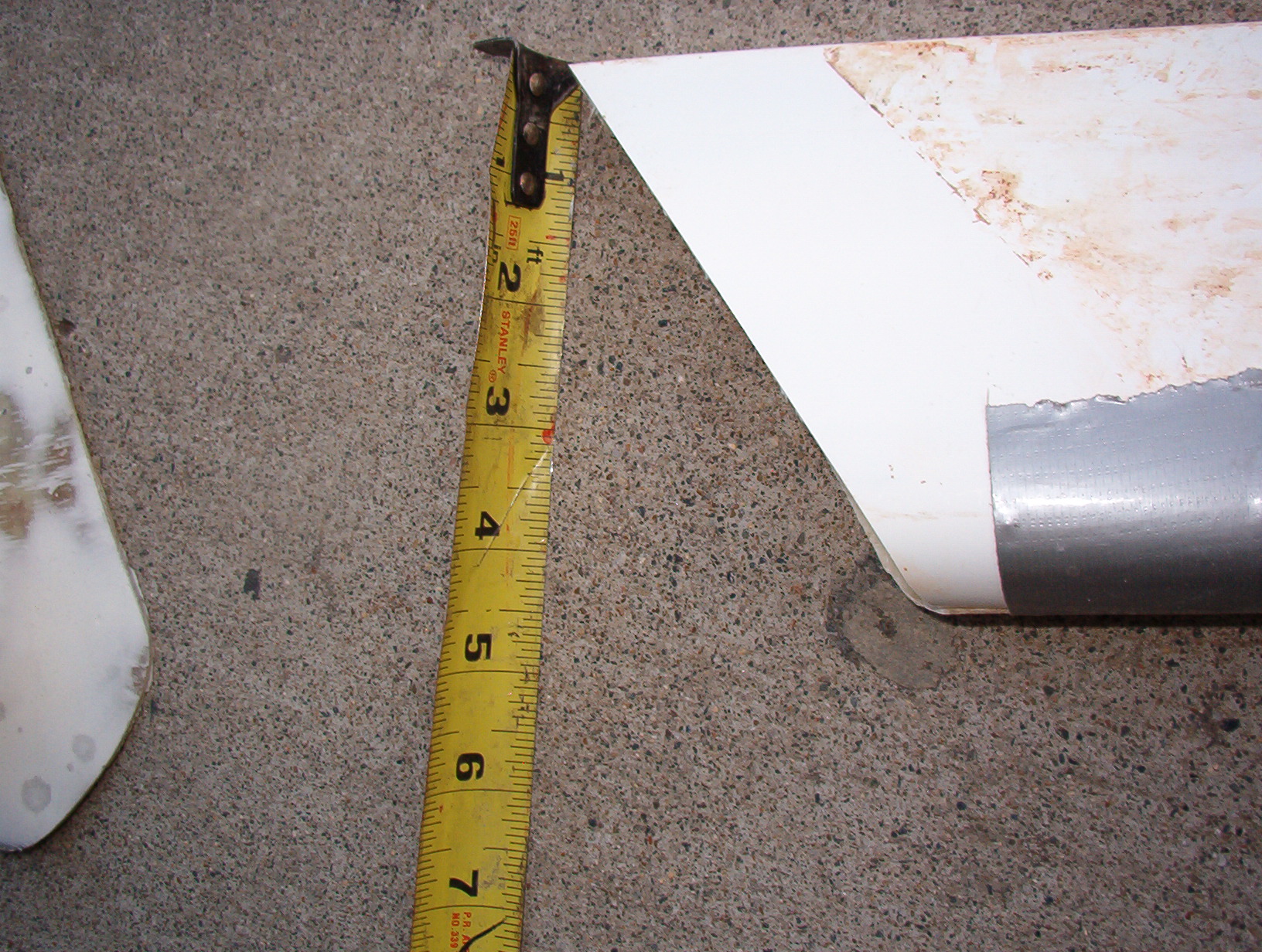

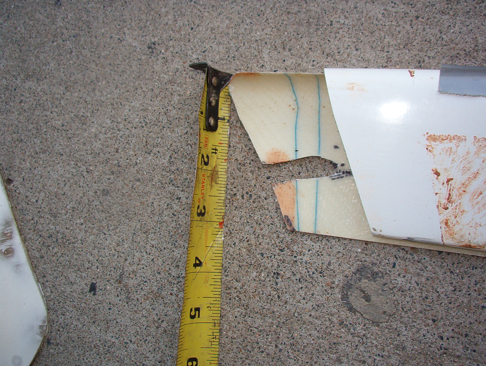

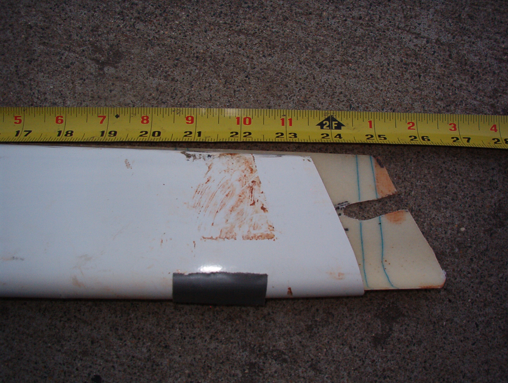

Hello all,
We transform the Kit N° 98 from mono to three gear
Does anyone give me the leg fairing dimensions and fixation type on the fuselage and on the wheel.
And pictures if it is possible
Many thanks
Michel AUVRAY

PostPosted: Mon Nov 14, 2011 4:34 pm    Post subject: Re: Main leg fairing dimensions Reply with quote
I took these pictures of my fairings. Hope they help
