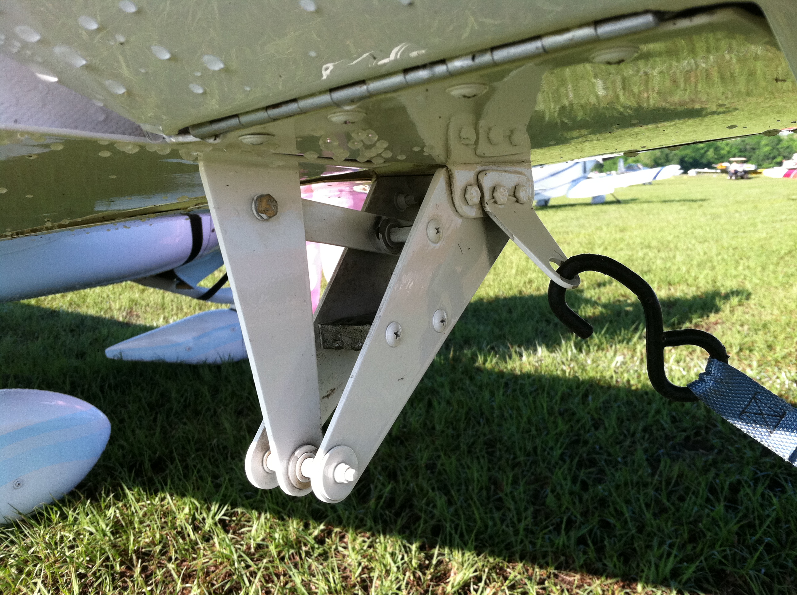

PostPosted: Fri Nov 11, 2011 10:30 am    Post subject: Tie down points Reply with quote
Max,
I fashioned a simple plate that I attached to the outside wing bracket.
Picture attached (if it comes through). It survived the tornadoes at
Sun-n-Fun this spring, unscathed, when a lot of other aircraft did not.
Jeff - Baby Blue

PostPosted: Sat Nov 12, 2011 10:00 am    Post subject: Tie down points Reply with quote
Hi Bob,
Many thanks for your answer. Could we get a picture ? (thanks to Jeff BB for the one he sent but without the speed kit)
Max  Cointe
