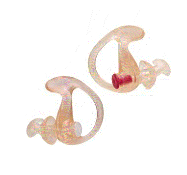

byoungplumbing(at)gmail.c
PostPosted: Fri Nov 04, 2011 7:14 am    Post subject: Headsets & hearing loss Reply with quote
how about mounting a set of ear buds in something like this
http://www.amazon.com/Surefire-Sonic-Defenders-Medium-Clear/dp/B0012XT8B6/ref=pd_sim_sg_3
the link has better photo, and if you scroll down there are other options one of the options has a flap with a plug that would fit in the hole, so i am nearly sure they are hollow into the ear canal.
been doing some searching for magnetic coupled connectors,,,, and found some patents and line drawings on what i would like to use to connect the ear buds to the inside of the headsets, but haven't been able to find a supplier. still looking.
boyd young
<snip>
boyd young
How about if you got some small diameter silicone tubing - the size that they use on model airplanes - attach it to the passage that runs through the Sonic Defender insert and let it extend to outside and below the headset cushion, and then attach the ear bud at that point? Hanging a few inches below the headset muff, with the tubing lying between your head and the headset cushion. Attach the ear bud wires to the head set as described in my previous post. Now the ear bud is not being smashed up against your ear by the inside of the headset, and you ought to have the best of both worlds. Sound dampening from the headset and from the insert both. Thoughts?
One caveat: some earbuds have an opening in the back for some sort of acoustic reason - if you used it in this manner, would it be better to seal that up? Would that not let sound pass through the earbud and on up the tube?
Richard Pike
Kolb MKIII N420P (420ldPoops)
Kingsport, TN 3TN0
PostPosted: Fri Nov 04, 2011 4:40 pm    Post subject: Headsets & hearing loss Reply with quote
tube?
Richard Pike
is the opening in the back an air passage way to eliminate pressure
differences in the inner ear to the outside air pressure,,
boyd young
