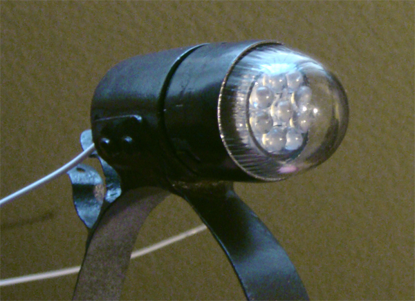

There are also replacements for the small exterior Chinese bulb. It's 24 volt, LED cluster that has the same bayonet base. This would be a direct, drop-in replacement for the lights on the nose gear, mains and tail cone. This particular LED arrangement has viewing angle of 90 degrees, so it is brightest when seen from straight ahead. Here is where I found this:
www.superbrightleds.com/cgi-bin/store/index.cgi?action=DispPage&Page2Disp=%2Fother_bulbs.htm
The web site navigation is a little confusing, but basically what you would be looking for is the 24 volt, white, dual contact, single intensity, 15 mm 1142 bayonet base. The ordering designation is: 1142-W15-24V White LED bulb - 24V. I've attached a picture of what this looks like installed.
