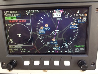

I have installed my Navwox ADS-B and am very pleased with it's performance.
Bill Moffit at Navwox helped me configure the unit once I had installed it. He dialed into my computer attached to the maintenance port and did the setup remotely. We did the setup around 7:00 PM on a Friday which I thought was awfully nice of him to volunteer.
The installation required one additional TXP and one GPS antenna. I now count 11 antennas installed on my plane.
I was concerned about the TXP antenna's location and I can report that I do not have any issues with it's location under the belly, between the MB antenna and about 3' from the VOR/ILS antennas.
The weather information is identical to XM's nexrad and metars, at least on my display. Nexrad seems to refresh every 5 minutes. My XM did not refresh in clouds, when I needed it the most, and I am hoping that ADS-B weather will update normally, regardless of flight conditions. I noticed that the weather resolution is much coarser when compared with XM on the same display.
The ADS-B box is connected to an old GRT (first generation) and kudos to GRT for keeping up with the technology. I did not have to purchase a new display to use Navworx. GRT had already incorporated the needed software in one of their routine software updates.
I find the traffic display to be dead accurate. I am aware of the traffic around me before the Center calls them out. Attached is a photo of the traffic display. Traffic Alert on the display only opens when traffic is within 2 miles of my position.
