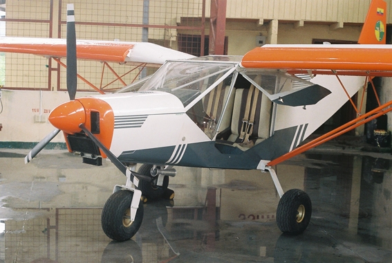

I'm thinking of getting the aluminum one from WarpDrive. Anyone know what
diameter to get? It looks like the 9" one goes over the pitch adjustment
clamps. Looks like the 8" does not cover them.
Curt

PostPosted: Wed Nov 02, 2011 3:27 pm    Post subject: Prop spinner Reply with quote
I used a 9" one from UHS in my "Terminator" (attached).
Francisco
