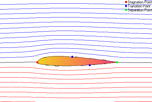

At high angle of attack stagnation point (pressure = dynamic pressure)
moves to underside of wing. Somewhere just below leading edge pressure
drops to below static pressure.
Stagnation point: see attached.
