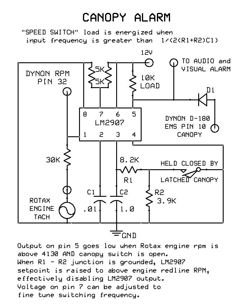

A canopy-open indicator light does not help much to remind the pilot to latch the canopy. The pilot will become accustomed to seeing that light on while she taxies, trying to keep cool with the canopy open. What is needed is an audio and visual alarm that ONLY activates if the canopy is not latched for takeoff. I thought about using a microprocessor but am not proficient at programming. Then I found this LM2907 "RPM Speed Switch". Although it requires a few resistors and capacitors, all of the active components are contained in one 8-pin IC.
Here is a proposed circuit: https://lh5.googleusercontent.com/-fI7pwRbufgI/Tqm5F18UY5I/AAAAAAAAAcw/QWs0GHx4q1I/s800/Canopy%252520Alarm.gif
And here is the datasheet for the LM2907: http://www.national.com/ds/LM/LM2907.pdf

Joe,
This looks like a good circuit, to minimize an important risk.
My concern is the connection between the circuit and the canopy latch
switch. Perhaps that would be subject to external influences ?
Bob, could you comment ? What might be the best change to make this
DO-160 compliant ?
Jeff Page
Dream Aircraft Tundra #10
DO-160 compliant ?
An astute observation my friend. Let
me noodle on this a bit . . .
Mike Welch

Jeff, Bob N, Joe, everyone else,
If someone isn't crazy about the mechanical "open/closed switch" in the circuit, would it
be a better (as in more robust) idea to have an optical switch? A simple tab on the canopy,
properly positioned, could open/close an optical switch as needed.
Just wondering.......
Mike Welch

Perhaps it would be better to connect the canopy switch to pin 7. I think the output will be disabled when pin 7 in grounded. Is that correct?
To Mike W., most any type of switch can be used. The switch is less likely to fail than the pilot's memory. Smile
Another option is a reed-switch operated by a magnet.
