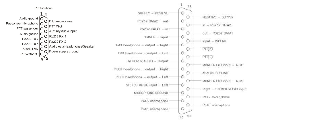

Radio
Here's what the V6 shows as being different from the V10, copied from their feature list:
Stereo music input with automatic fade down on intercom activity.
Two auxilary audio inputs, mono, for mobile phone and EFIS annunciator
V6 frequency list editor: (Windows, any 32 bit version)
This small program allows you to download and upload frequency lists to and from the V6 tranceiver. You can edit these lists and maintain several different lists if you like.
V10 is mono, although its manual mentions stereo. I read one of Rainer's posts on VAF saying it's mono, which makes sense if I read their pinouts correctly. V10 is on the left, V6 on the right below.
If the only difference between the units are the few extra features listed and its size, I may look at getting a used V10 from someone upgrading. I'd have space for either.
