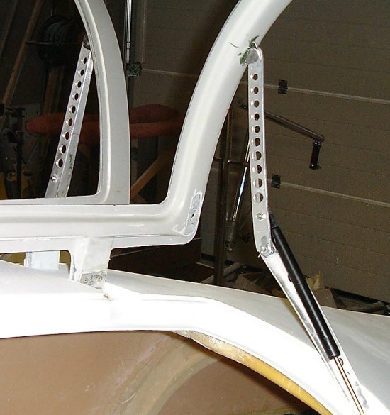

There is a mod I believe first conceived by Ted Gladstone and Justin Kennedy. Kingsley Hurst adapted it further and I took Kingsley's method and modified it for my installation. The bracket hinge system removes essentially all load the strut puts on the door and frame, whether the original or subsequent door strut mod is used. Attached is a picture of the Gladstone door hinge.

grahamsingleton(at)btinte
PostPosted: Sat Oct 29, 2011 12:24 am    Post subject: door warp Reply with quote
Bikk
imho this is the best way to do it. As you say, there is no l;oad on the door or the fuselage. All loads are absorbed by the strut linkage.
Very clever but a lot of work. Be nice if someone produced the parts. how about it Justin Kennedy?
Graham
