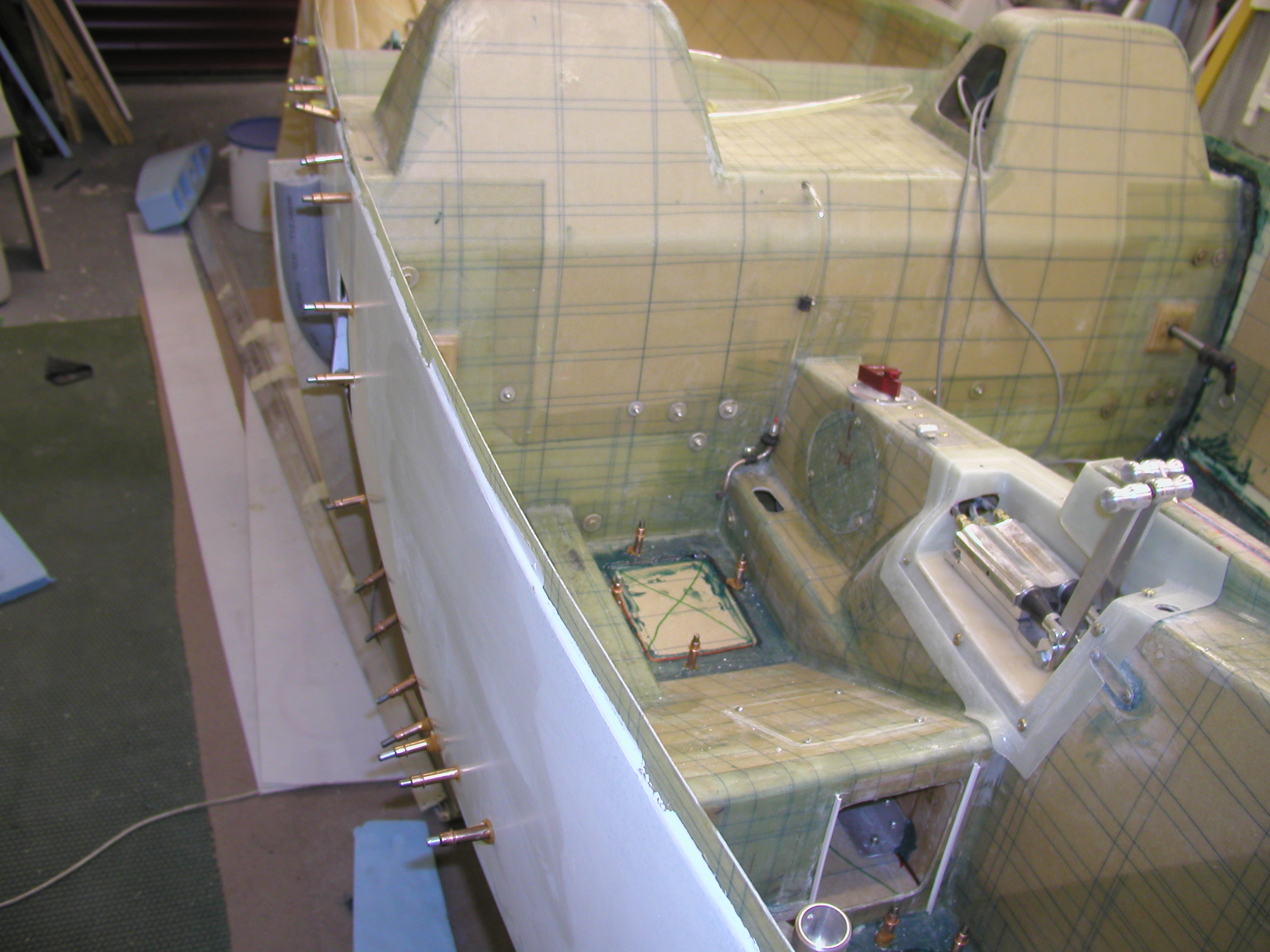

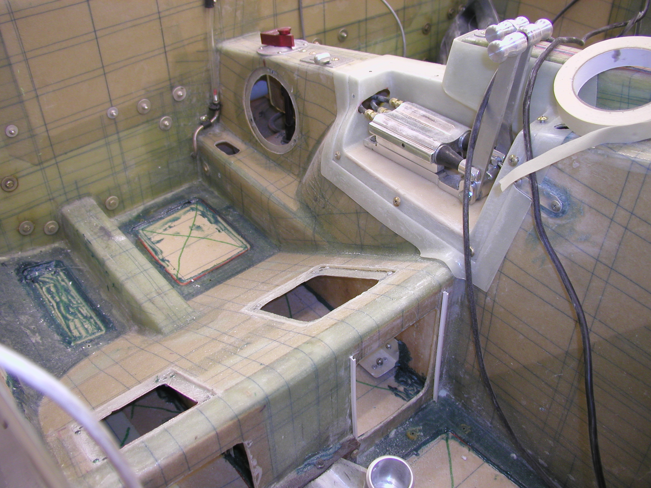

To comply with the LAA regulations i did fit a sight tube,      but I kept it to the minimum length i could get away with,
It comes up between the strb seat and tunnel and runs up the seat backrest then routed over the top of the tank to the
Cobra filler pipe,
I calibrated it on the ground and it gives a accurate reading and is helpful to watch the clear pipe filling up
towards the cobra when my tank is nearly full, But is not much use in the air
I also know exactly how much fuel is in the aircraft before putting any more in which is helpful, have included a couple of pics to give you the idea of what was done,
