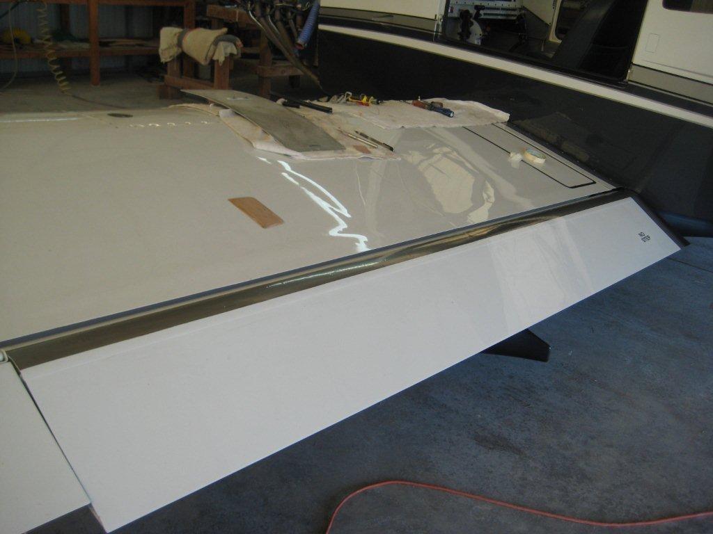

We recently removed my 3 year old UHMW tape from my RV-10 flaps due to unsightly pealing in the corner. It was not difficult to remove with heat but also probably because it was not many years old. We have since replaced it with SS tape. Hopefully the SS will hold up but I have my concerns.
What are people recommending for placing on the underside of the wing skin to prevent/minimize abrasion of the SS Tape or flap? I have heard people using the "loop" side of Velcro as the buffer but I am not sure it's ideal due to its thickness. Any suggestions out there?
