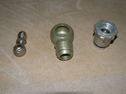

I have attached a photo of components that came with the motor that I do not know what they attach to. If you could advise me I would appreciate it.

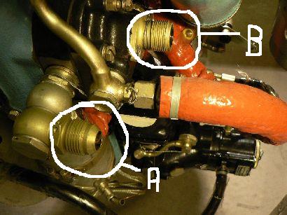

I have also attached a photo of the oil pump. I presume that what I have marked as "A" is the oil intake from the oil tank and "B" is the return to the oil tank, please confirm.
What type of thread is on outlet "B" and where can I find a fitting for this? The one way valve in the picture does not screw onto this fitting.
The installation manual page 5-5 shows the oil system with item 6 a "thermostat safety valve". Is this built into the engine or do I need a separate unit.
Where do I access item 7 on that diagram the "oil filter chamber"

A is oil return to tank.

B is not an oil fitting. It's the tach drive.

Thanks for the help, I had another look at the engine to-day, cannot see where the oil inlet could be. Any chance that someone could describe where the oil inlet is located?
If I am not using the tach drive how do I cover it up?

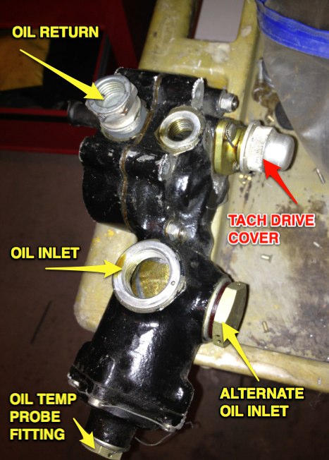

There is a threaded cap that closes off that port when not in use, but you don’t really need it. You can just leave it open, or you can use it to drive a tach. UMA instruments make (but do not advertise) a tach generator for the LOM drive. It is designed to operate their 3 1/8” tach with hour meter.
I can show you a picture of a spare pump that I have which shows the oil ports:
[img]cid:3402338621_215599[/img]
Notice that you can use either of two inlets. The non-return valve I identified in your earlier posting screws into this. The oil inlet hose then attached to that valve.
A standard American oil temp probe will screw into the fitting on the botton of the oil screen chamber.
Steve

Thank you very much for putting in so much effort. That really helped me a lot. My pump is slightly different as it has only one inlet but the one way valve does screw straight in.
Now my next problem, any ideas on where I can find an adapter to fit on the end of the one way valve that will enable an AN fitting to be used?
Am I correct in thinking that there is no thermostatically controlled by-pass valve fitted. If anybody has fitted an oil cooler how do you control oil flow to the cooler?
How do you clean the oil screen chamber?
Mike
There are many sources. Use Google. Places like Summit racing are a good place to start. You can buy metric hoses and fittings as easily as AN now. It is also a simple matter to put a metric fitting on one end of a hose, and an AN fitting on the other.
Some people just put cooling fins on the oil tank, some use a cooler. LOM do mention a thermostat but I have never seen one. If you find you need an oil cooler in the summer, disconnect it in winter. My aircraft is open cockpit, so it doesn't fly much over the winter.
Like most things LOM you follow the manual. In this case, it says wash it out with kerosene then with gasoline.
