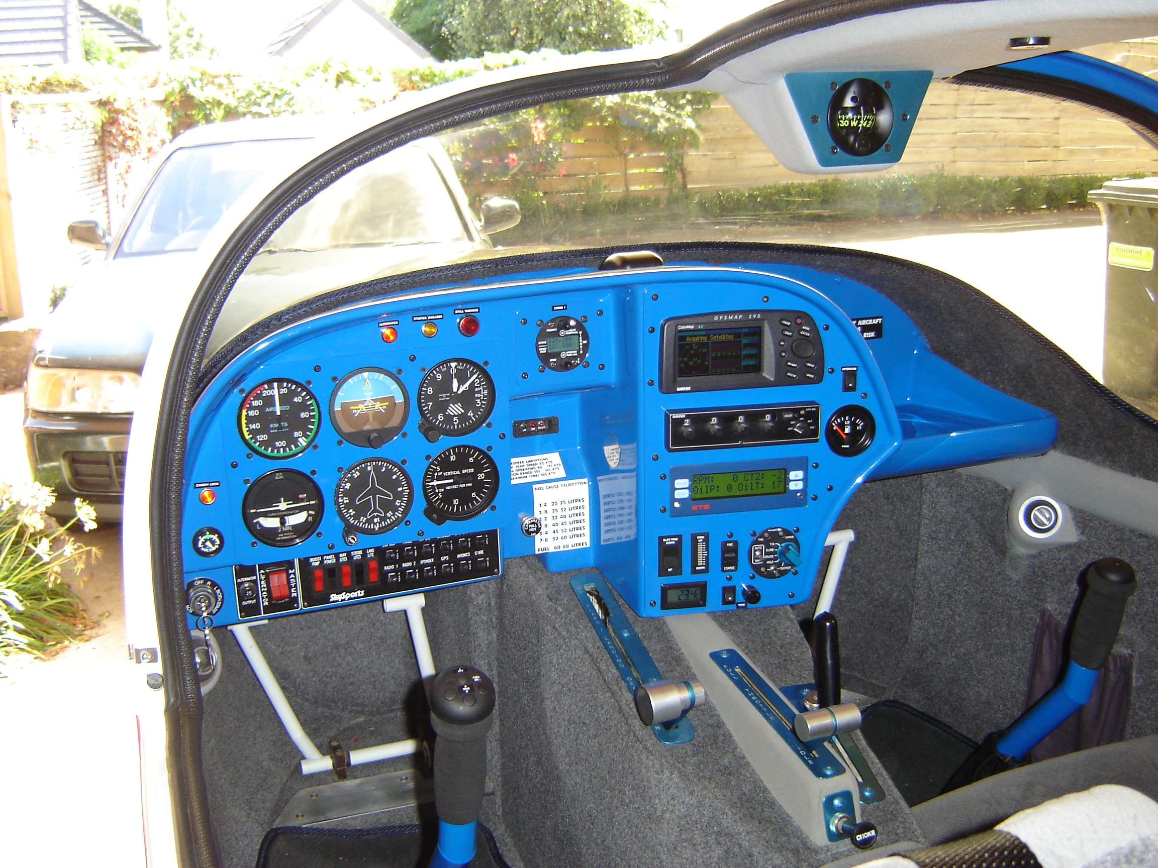

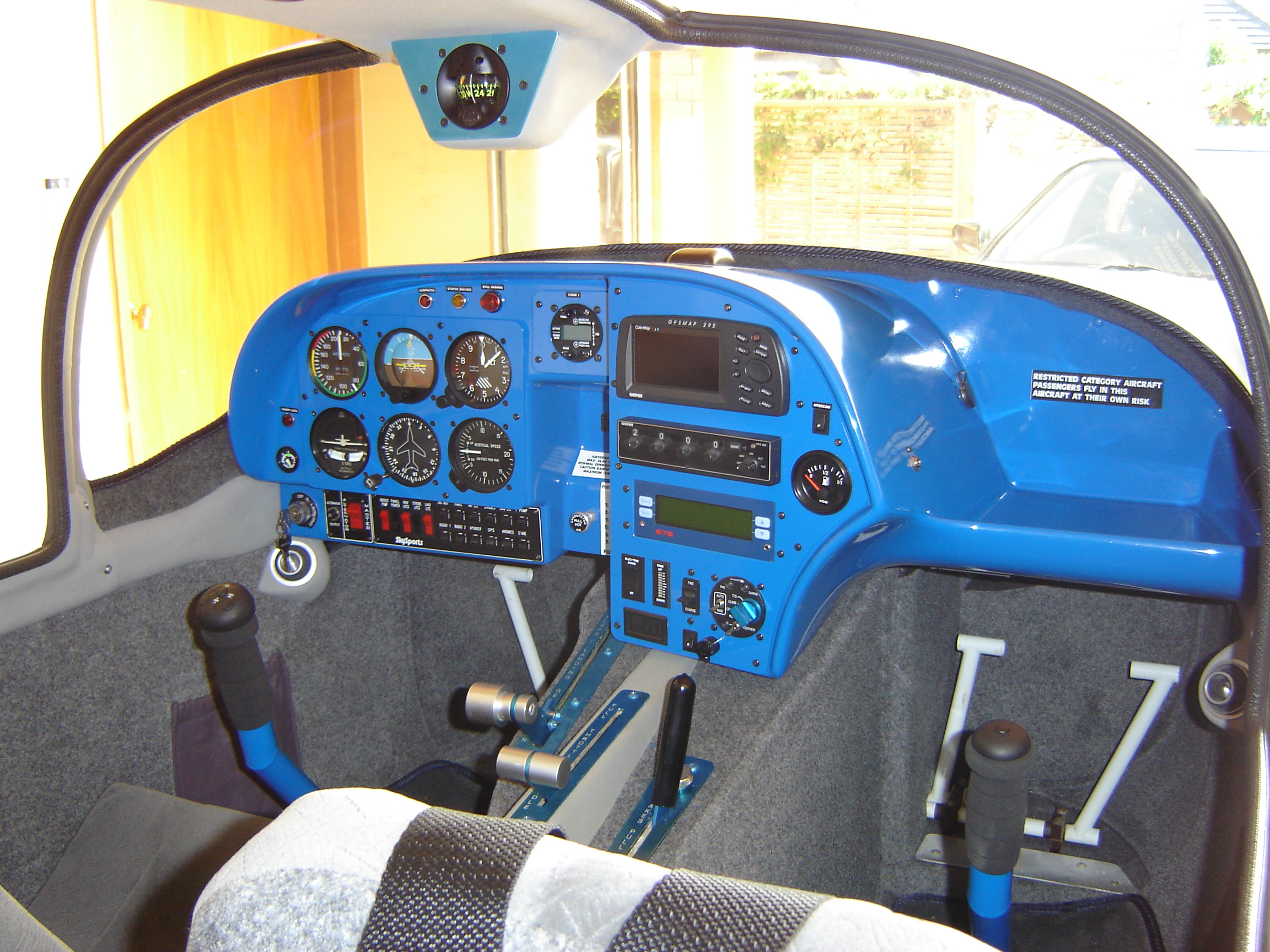

Hi Paul,
Yes a couple of us here in New Zealand have used the mini power panel or Sport Panel as it used to be called, it works well and slides in nicely under the main panel as per the attached photos, I would recommend it for simplicity
Cheers Gavin Lee ZK-EPA #355………….NZ 20……..Australia 6

Hi everyone. Building a NG trigear & need some advice on avionics panel. To simplify matters I was considering using a commercial power panel such as the TRAYMOUNT EXBUS2V, LIGHTSPORT or MINI POWER PANEL as found in Aircraft Spruce catalogue. Does anyone out there have any experience with these units. Thankyou. Paul Munford
