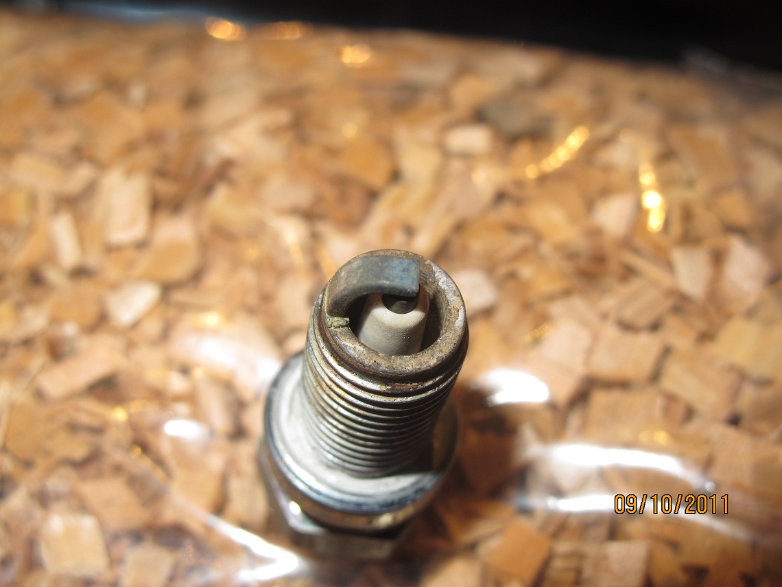

One week ago on Sunday I looked, found and solved the source for vibration as follows:
First I checked the overall appearance of the plane – good
Then I took the prop for a closer check and drove the blades to their finest positions – all very exactly 17 degrees (measured from the tip end).
Then I drove them to the coarsest position – all were again same and 29,5 degrees,
Opened the cowlings – just normal inside.
Took off all the sparking plugs – one until another were just great – colour like mild milk coffee...
- until I took of the last (!) one: that was #3 (stbd side, rearmost) and lower one: it was sky blue (a colour like RAL 5015 or Pantone 2925C).
It /they have been on service 57 hrs only.
Attached a pic of it (it was not so easy to photo it to get a correct colour!).
I replaced all the plugs for new. That was it. As I wrote earlier – My Europa was after service just great.
My mistake: I did not try during the flight one week ago the magnetos A and B alone. I could not imagine that would be a solution for a smoother ride. You remember – one power selection and one rpm-selection only together was acceptable to continue the flight with a reasonable vibra only.
How could loosing only one plug to make such a hard situation? My only guess is that it was detonation; below and over certain rpm´s and map´s the engine was very unhappy. Why so – I am sure someone of you can explain it. Certainly the plug has been very hot.
I consulted a Finnish Rotax agent: during a last decade he remembered only another case loosing a spark plug from Rotax. That case the spark was only dead and no noticeable problems during the flight. His ten years are equal of well over 200.000 hrs of Rotax flight time (200 planes x 100 hrs /year x 10 year).
Dear competitors: I got several answers. Some of them are a bit funny but all are valuable. Thanks for great inputs. All of you, also those privat answers.
Only one of you guessed the right answer. That was Bob Yearly by writing as follows, that was a great list for all of
us, thank you.

Dear Raimo,
As I remember I wrote sparkplugs, maybe to generic?
Maybe then only half right?
Most important is
What do we learn and how to avoid....(from your experience that is)
Thanks for sharing your experience!

Hi Raimo
Perhaps my eyes are not as good as they were, [?] But i cannot see any
Silicone paste
residue on the threads of your spark plug, Rotax recommend it to reduce
Spark plug temps,
I have used Dow corning DC340 to good affect on my engine,
best wishes
Ivor
us, thank you.

Hi Ivor
I am sure they (your eyes) are. You saw right. There was not any paste left in the picture, but there was when replacing them!
It was wiped off because I put those old plugs to their tight collecting box, which I made by white foam you know. Paste which is left is there...
Cheers, Raimo

Hi Raimo
Perhaps my eyes are not as good as they were, [img]cid:457D69AA758146D5AFD9BB7C060C6899(at)Asus[/img] But i cannot see any Silicone paste
residue on the threads of your spark plug, Rotax recommend it to reduce Spark plug temps,
best wishes
Ivor
