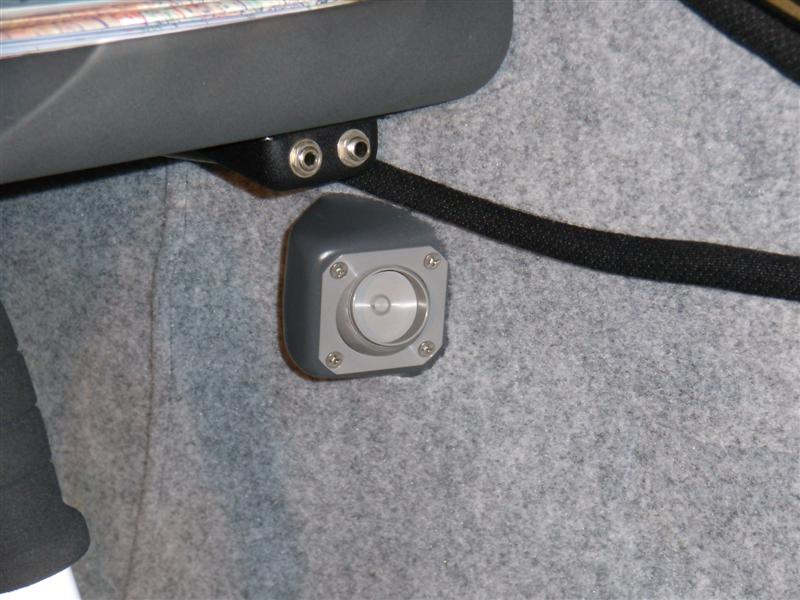

The vent mechanism is crap. Mine also broke long before I finished building.For a few dollars ACS supply a repair kit, which is unbreakable.
Cheers,

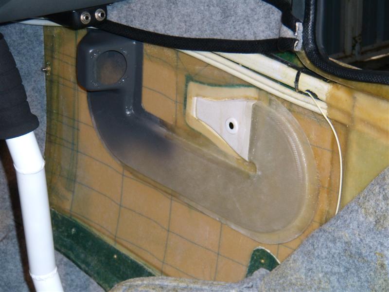

The co-pilot's vent broke at the base of the plastic screw the first time I tried to open it after installing it. I used super glue , but there is a small opening when closed. I figured that I'd have to tape over it during the winter months or when I went to 12-13K.
Has anybody coming up with a good fix? I'm going to the paint shop in the next couple of weeks.

I formed my own NACA vents and ended them at vents that I got from a car scrapyard. I think they are from a Ford Fiesta 1990's vintage.
Fantastic. Robust & lots of air.
I looked at the ones on offer at that time and thought that they were pretty junky & they do not seem to have improved!
Barry

PostPosted: Fri Oct 07, 2011 11:48 pm    Post subject: Re: Naca vents Reply with quote
Hi Guys,
My solution to repair and improve the Naca vents was to remove the shut off system, make a fiberglass conduit and install adjustable aluminium vents.
Works fine. See attached pics.
Remi
F-PGKL
 Filesize:  76.23 KB
 Viewed:  9300 Time(s)

pjeffers(at)talktalk.net
PostPosted: Sat Oct 08, 2011 4:27 am    Post subject: Naca vents Reply with quote
Hi Remi,
Nice looking job!
This is a very similar solution to ours. This works well and is a good
adaption of an appallingly unacceptable piece of expensive rubbish.
In the UK we would define this product as 'unfit for purpose' and as such
should be outlawed. (but I suppose it is still being sold)
Pete
