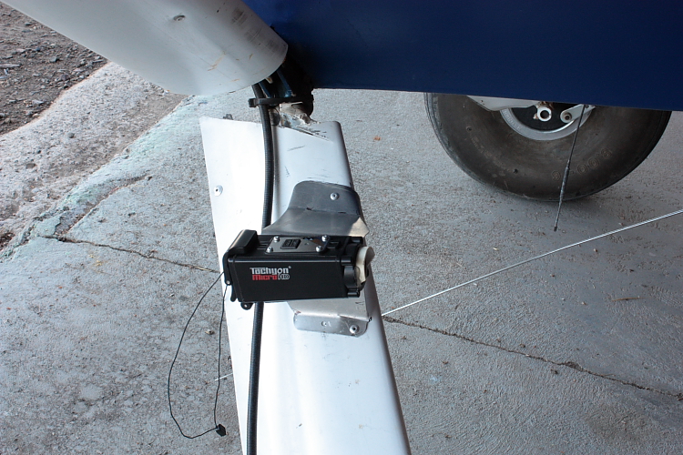

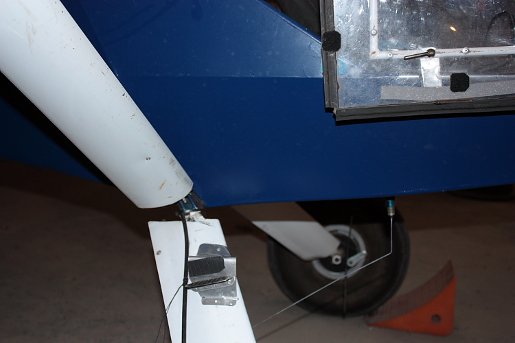

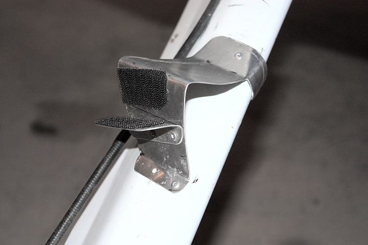

As most of you know, I bought a Tachyon HD camera, and I have been unable to get the harmonic wave out of it. It has been very disappointing to say the least. I was able to tame all that with the regular Tachyon (at) 480, but something about the HD mode will not be tamed by foam. If one sticks it on their head it does fine, but you end up with greatly reduced visibility shooting through the wind screen. The fella that shot the recent video with the camera mounted on the gear leg impressed me with the stability of the video, so I thought that I would try it and see what would happen with this Tachyon.
The attachments show what I came up with. I made a preliminary flight test today and found that at max throttle of 6000 RPM's there were no harmonics, but at 5400 where I normally cruise, I had some, not as bad as before, but more than I want. Tomorrow I will, weather permitting, do some more testing and see what RPM's give me the best video. It does look promising for a change. The nice part of where it is located, is that I can reach out the back of the door and turn it on and off as I need and cut down on battery usage, and editing.

The list is so quiet, I doubt if we will be disturbing anyone. It is engine harmonics that affects the camera. The way that it is now is as solid as I can make it. After all it has a 400 pound airplane attached to it by Velcro bottom and side, and the mount is as solid as I could make it. As I said I didn't have any problem with the regular camera that recorded at 480 mounted in foam to absorb the vibration, but the HD is another thing altogether. My test flight was with cleko's, I have now riveted it in solid and the gear leg covering is foamed in pretty solid. The weather should cooperate today and I will try to see if I can find a rpm setting that will stabilize the thing.

I just landed after my RPM tests and am putting together a video that will show my findings, but that will take a while. Should be online before evening. In essesence here are the findings. The HKS top cruise is 5800. I did a few minutes at 5800 and found that there was a bit of shake. At 5600 it smoothed out and was as nice as anyone other than a perfectionist could ask for. At 5400 which is where I generally cruise at and is best speed verses fuel consumption, it shakes enough to piss me off. At 5100 which is minimum cruise to my mind, it is as steady as a rock. The wife says that it is so slow that it is boring, so I guess it is 5600 RPM's for me most of the time.
Keep in mind that if one used a three blade prop, or a different engine all that would change. The best part is that it is possible without too much trouble, and I can turn it on and off while I am flying. That has to be done manually since this one doesn't have a remote. It takes some serious batteries to run this little sucker, and by only using it when you actually want to record something you could use the cheaper Duracell type.
My gear leg covers are of aluminum filled with foam.
