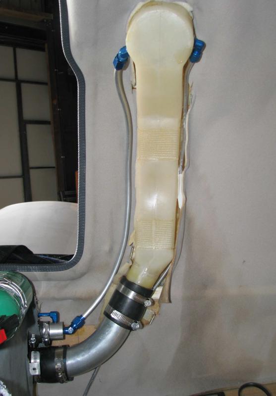

run the tank breather in 3/8 aluminium from top of tank to just below top of filler cobra. Then run the in flight breather in 1/4" down to just behind and below the flap.
Metal is best but needs to be grounded to prevent static build up. Fuel droplets in a plastic tube and hi speed airflow will charge up like raindrops in a thunderstorm.
Happened at least once that I know of.
I've attached a pik, the blue fittings are bulkhead swaged fittings, easiest way to attach if a bit expensive.
Graham
