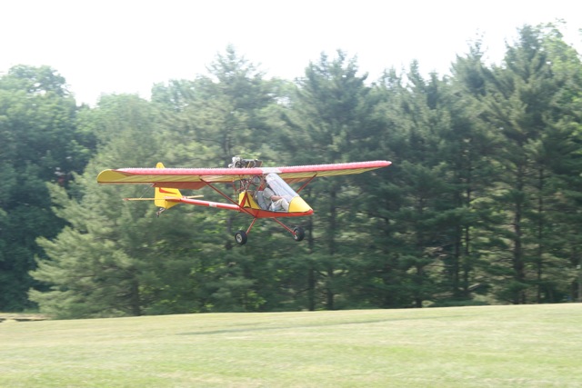

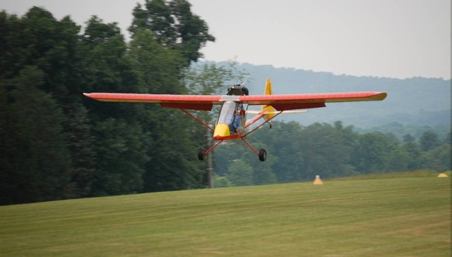

Eugene Zimmerman
Posts: 392
PostPosted: Sat Oct 15, 2011 12:56 pm    Post subject: Flaps or falparon on the Firestar 11 Reply with quote
On Oct 15, 2011, at 1:26 AM, SAILNROCK wrote:
Hi All
Has any one made flaps or done flaperons
like on the firefly? On the Firestar 11
And if so how did it come out and with what benefits?
Thanks Bob
http://forums.matronics.com/viewtopic.php?p=355079#355079
 Filesize:  55.23 KB
 Viewed:  12986 Time(s)
 Filesize:  80.09 KB

Gene Z/Gang:
The last photo was shot at Homer's, wasn't it.
Looks good.

PostPosted: Sun Oct 16, 2011 4:50 am    Post subject: Re: Flaps or falparon on the Firestar 11 Reply with quote
Thanks All Nice reply's,
Eugene nice Pic's , Do you have any info? Did you build them? What was your improvement ?
Has any one done flaparon like on the firefly on the firestar ll ?
