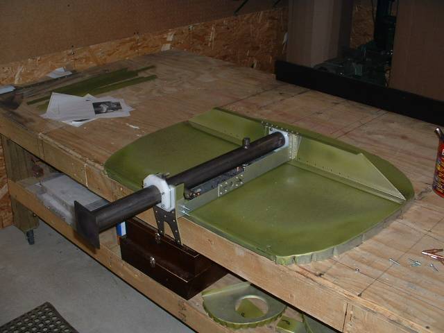

All-
I just tuned in to the thread, and I hate to say this, but every
installation I've seen was .5" thick, not 1.5". No wonder the raw
material was so expensive, Mike.
Ron, if your prints call for 1.5", they're wrong. I have Larry
Mac's beefed up (reinforcement ridge on the outboard side) bearings and
I estimate they can be machined out of 3/4" material. I'd say the
factory bearings could be made using a 3x6" piece of 1/2" stock.
Bill

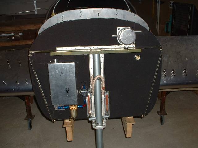

PostPosted: Fri Oct 07, 2011 2:22 pm    Post subject: 601 XL bearing bloc material Reply with quote
On 10/07/2011 05:58 PM, mtherr(at)yahoo.com wrote:
Oh, ratz! I will mill it down 0.004" before i cut the V groove Wink
 Filesize:  35.26 KB
 Viewed:  15335 Time(s)
 Filesize:  34.07 KB
