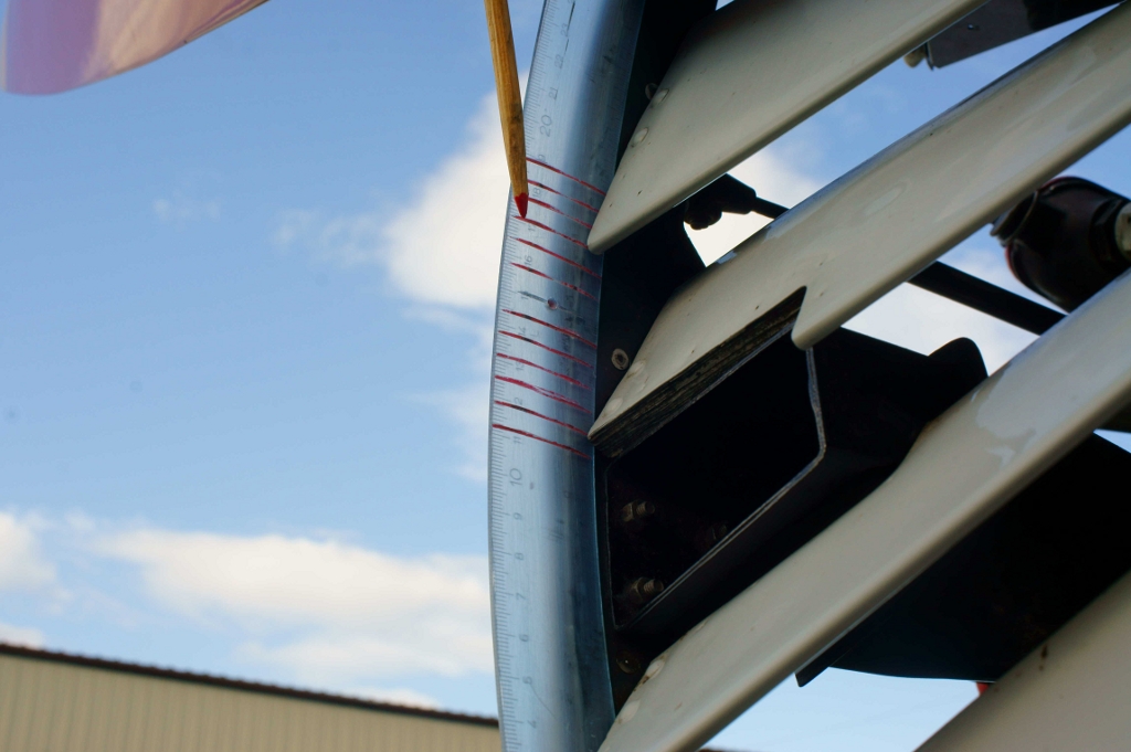

Then I jam the ruler between the half
way open vanes and outer cowling
ring. There are 28 shutters, so divide
them by 360 degrees and you have
exactly 12.86 degrees between 2 vanes.

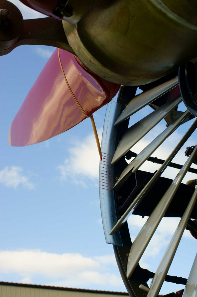

I affix the pointy chopstick to the propeller
using the elastic, are you still with me?
The TDC tool shows the piston has reached TD,
I move the ruler so the chopstick points
on zero. Then I pull the prop further until
the TDC tool pointer starts to move again,
now I have the dwell factor and just divide
it by 2, indicating the exact TDC on the ruler.
Now I look at the embossed pre-setting number
on my magneto (e.g. 23 degrees), subtract
this number from the pre-ignition angle with
fully advanced flyweights (e.g. 31 or 27 degrees,
depends on your engine), multiply it by the
gear ratio, in my case 0.787 and set my timing.
Job done and no fancy tools involved.

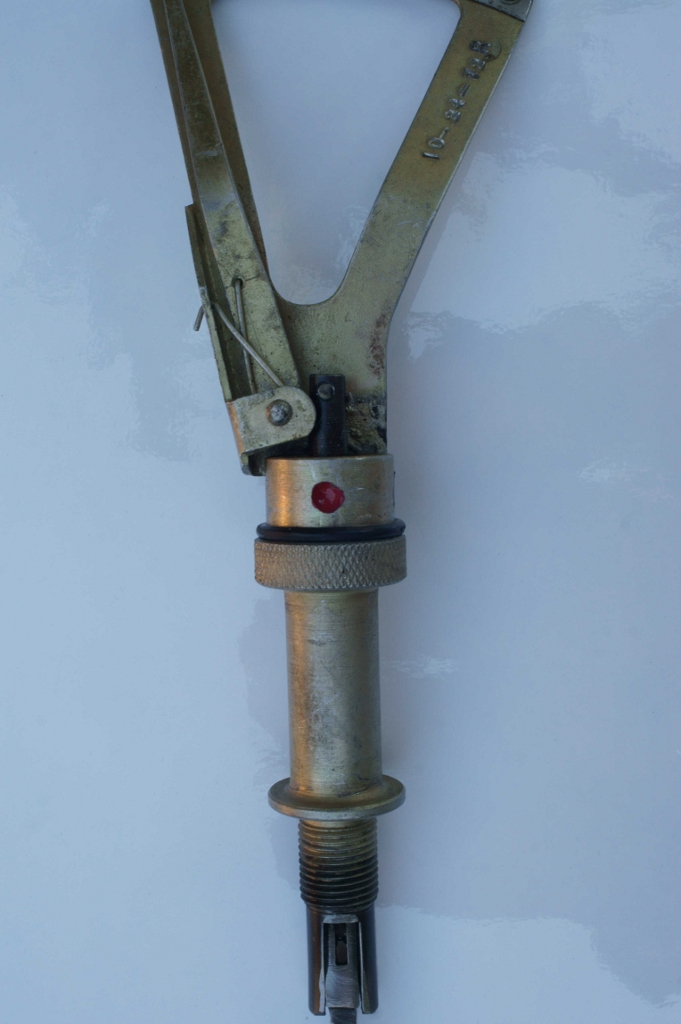

the tight fitting o-ring is below
the red dot. Its applied friction
hampers the tool to turn while
you are pulling the prop. But don't
screw it in all the way, it might
disengage the pointer from the push-rod
and will get you into "Teufel's Kueche",
Dennis has been there twice.

Can you send a picture of where you placed the O ring. I'm soon to be needing the Device in a couple weeks as I'm rebuilding my M14P after it was FOD'd. This has been a real educational experience to say the least.
Doc

On Oct 11, 2011, at 1:29 PM, Elmar Hegenauer <samira.h(at)shaw.ca> wrote:
Bonjour Didier,
Again, IMO the original TDC indicator is NOT
a timing setting tool but a much more precise
TDC and TDC-dwell finding contraption through
its higher push-rod to pointer ratio.
More pictures to follow the next days.
cheers
Elmar
<TDC-Fix1.jpg>

PostPosted: Thu Oct 13, 2011 7:54 am    Post subject: How to set magneto timing by using simple tools Reply with quote
Didier and others,
here come the promised pictures.
Have fun.
cheers
Elmar
 Filesize:  439.51 KB
 Viewed:  9945 Time(s)
 Filesize:  392.14 KB
dsavarese0812(at)bellsout
PostPosted: Thu Oct 13, 2011 8:17 am    Post subject: How to set magneto timing by using simple tools Reply with quote
Very ingenious Elmar.
For dummies like me, I bought this timing tool which works perfect,
especially if the airplane has a spinner because the spinner backing
plate covers the timing marks on the prop flange.
http://www.aircraft-tool.com/shop/detail.aspx?PRODUCT_ID=E25
Disregard the TDC tool. Won't work properly because it is a geared engine.
Dennis
