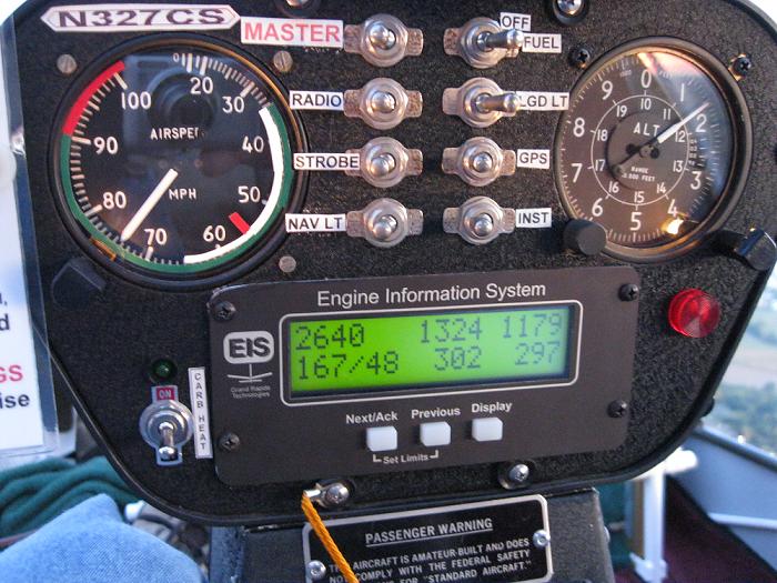

First of all....I have no idea what jet I have in my carb...and I only have cht and egt for 2 cylinders which to start with were on cyls 3 & 4 ( the ones toward the leading edge of the wing)..before I changed the cht to 1&2, cht's on 3 & 4 would run 260 - 280* ..but since I over headed my #2 cyl in a ground test run last winter I moved the cht's to 1 & 2 so I know what the back cylinders are doing...when you look at the picture I submitted, remember that the egt's are for the front cylinders and I suspect #4 is lower because the compression was lower in that cylinder and this winter I may clean up and re-ring that cylinder...how ever , since it doesn't burn a drop of oil now after redoing the #2 cylinder and at that rpm it seems to burn 3 gph,I may not do anything with it. I wish I had probs on all the cylinders...

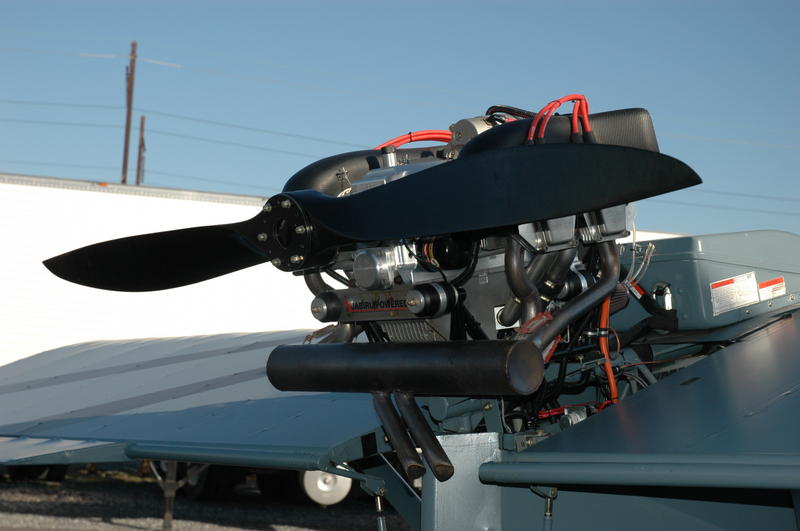

Tilting the carb WILL make a difference...after I got her together this summer I had the carb on straight and level and on climb at WOT my egt's went to 1390 and when throttled back went back down....after tilting the carb a couple of times I never had a problem.
my cht 's even on 95* days stay at 320* and coming home the other evening the OAT was around 65-70 *.
I'm not sure what to tell you,but hope this gives you something to shoot for...according to Jim at Jabiru Pacific I'm right in the ball park .

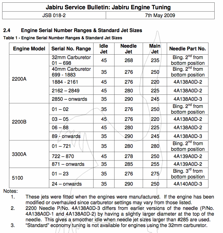

I just got back from the Jabiru Engine seminar at Great Barrington, Mass. last night and learned a good bit from this excellent class which was far better than the Rotax 912 class I went to about 6 years ago.
Both the CHTs and EGTs are important but must be addressed separately. Let start with the EGTs.
1) The float bowl vent nipple MUST be connected to the clean side of the air cleaner for the carb to have stable mixture.
2) The location of the Carb directly behind the BRS (just like on my Slingshot) is not an issue, so ignore what "someone said " in this regard.
3) My carb has the original Bing Jet Needle in it, not the newer Jabiru designed needle.
4) I tried changing the main jet to reduce EGTs at WOT climb. Mine was not as bad as yours but too high. This helped a little but not enough, even with two sizes bigger main jet.
5) I changed to smaller needle jet to increase cruise EGTs, again it helped some but not enough. Mine were not as bad as yours.
6) Pete Krotje told me at the seminar that the jet changes are not as effective with the old Bing needle as they are with the Jabiru needle so changing that will be my next step and I suggest that be yours too, if you have the Bing needle.

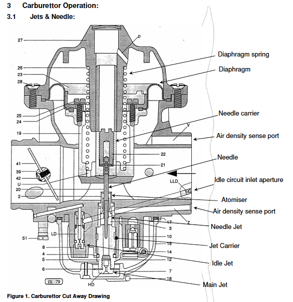

You can easily tell which needle you have by looking at it. The Bing needle has the straight (linear) taper. The Jabiru needle has a visually obvious step, no sharp edges but a rather quickly changing taper. You can see this without dismantling the carb. Remove the air filter, stick you finger in the inlet throat and raise the piston/slide to see the needle. If your carb already has the Jabiru needle and you change the jets and it doesn't work, your next step is to call for technical help from Shelbyville.
Attached is an image from the Carb Tuning service bulletin JSB018-2 which shows which jets/needles are recommended base on your serial number and carb size and lifter type. Take these as a starting point and make small changes from there.

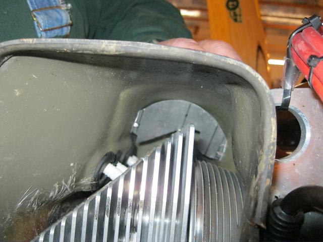

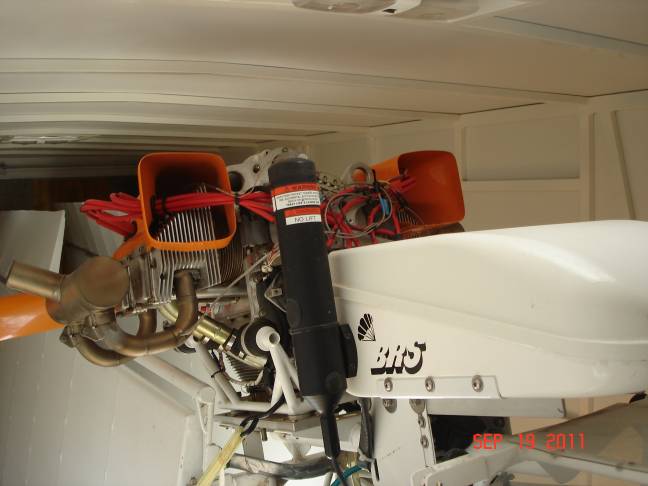

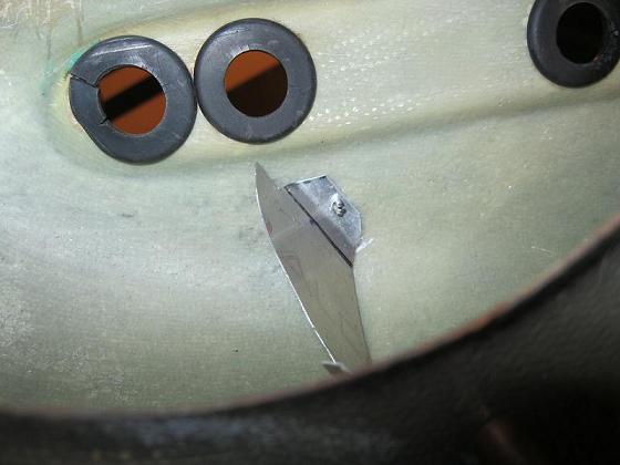

Thom...
Am I headed in the right direction??

It is difficult to tell from your photos but the last one looks like it is about right for the rearmost cylinder. The front cylinder air deflectors should be no more than half that height (maybe less?), as a starting point.
Keep in mind that the goal is to have approximately equal amounts of air flow downwards around both cylinders on each side. Make your deflectors such that they look like they might do that and that should be a good first start. The one thing that I did notice is that the deflectors are mounted directly above the centerline of the cylinder at approximately 45 degrees from the straight back airflow (like full flaps on the wing) thus deflecting part of the air downwards.
What have your CHTs been running in cruise? How much difference between hottest and coolest? What about oil temp?

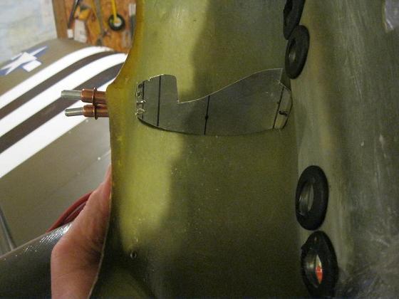

The prop is a warp drive 58" ground adjust. The most rpm I have gotten in a climb is 3k but mostly 2900 to 2950. (when the tube was attached to the carb is when I saw the 3k). I do not have any baffles in my air scoops at all (picture attached). Can you give more info on the front baffles and rear baffles, I think I understand how to make the top baffles pointing down on the plugs. If making a fence on the front of the front 2 cylinders how do you attach it to the cylinders ( just screw into/between the fins with the right size screw?)
I checked my needle in the carb and it is straight as an arrow, no taper that I could see. Is that hard to change?

The first thing I notice looking at the photo you posted is that the spark plug wires should NOT be routed through the opening of the air ducts. They are blocking a lot of air flow. Mine are routed over the top. See attached photo.
The jet needle can be changed easily by removing the top(27 in drawing) of the carb (4 screws - 28 in drawing) and pulling the diaphragm/slide out. Once the slide(19)/diaphragm is on your bench take the largest common screw driver that will fit down in the center hole of the slide and remove the aluminum plug from the slide. This threaded plug (22 in drawing) holds in the jet needle. The needle is held in the slide with a tiny circlip(21 in drawing). In the Bing needle there are 4 annular grooves that the circlip can be located in. Normal position is third from the top (2nd from the bottom). Replace this with the latest Jabiru needle for the 4 cylinder engines. The Jabiru needle has only one annular groove for the circlip. All this assumes that some idiot did not put too much torque on the aluminum plug when screwing it in OR applied permanent loctite on the threads so you can't get it out. MINE was like that so I got another slide/diaphragm from a surplus Bing 94 carb which I can remove the aluminum threaded plug from. I do not use loctite when replacing this plug because it is aluminum and therefore has a high coefficient of friction and will not back out by itself. Don't overtorque it or you won't get it out again.
When you've replaced the Bing jet needle with the Jabiru jet needle (call Jabiru USA for this part) in the slide and the aluminum threaded plug, it is time to replace the slide/diaprhagm into the carb top. The bottom of the diaphragm has a protrusion on one side and one side of the carb body has a matching depression in which the diaphragm protrusion fits into. These must be aligned carefully when re-fitting the carb top.
Hope this helps.
