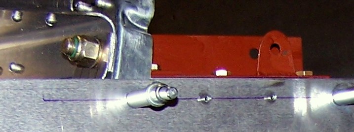

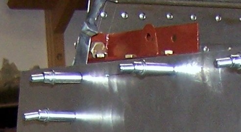

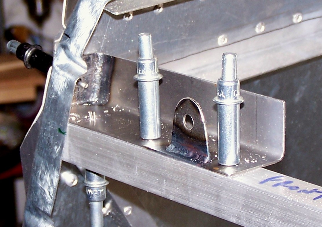

Here are a few pictures I found of the part delivered to me. I took the pictures in the last part of 2006 so I must have ordered them some time before that.  I ordered my kit as subkits when I was ready to move on to each part of the plane.
I don't have my drawings here (they are at the hangar) so I can't tell you the part number on the drawings.  As I recall there was a significant difference from the part on the drawing and the ones I received.  Sorry, I just don't remember the details of the difference.

Paul, please tell me more about those fittings. This has proven to be a weak point on my 601HD (version 5 plans).
I made new one with same layout but .080 4130 steel instead of .050.
