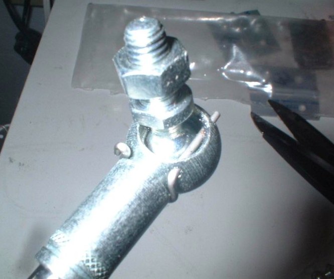

Gidday,I have had my door strut hydraulic struts on and off so many times, and co-incidentally arm really glad the end caps, the ball joint cups are plastic. So, when the time comes I reckon it might be worthwhile replacing them, or having spares. I have seen photos on EuropaOwners of Dan Bish's album of a metal cup with a locking cir-clip pin rather than the plastic ones. He is unsure where he got them from, maybe Europa, and so I am wondering if anyone knows where these can be sourced please??

Very nice setup with the locking cir clip. I have had my struts dislodge twice in 5 years, merely due to the bolt attachment coming loose. Otherwise the ones that are issued are quite OK and lighter in construction. Remember the the cir clip will not release the strut from the ball when needed under stress and therefore may do damage to your composite metal tongue the ball is bolted to. Just a thought.

I had the same problem and replaced them by metal ones which I bought
from the Europa company.
These end caps are slightly longer so it is likely you have to adapt
something, but it is worth the trouble. I never had an end cap sprang
loose after that.

Europa Company supply these and whilst acknowledging the risk of them being more secure at least you do not worry about the doors detaching on the ground in strong winds.

my P1 side plastic ball joint became loose and the metallic ball popped out several times.
That happened several times only during I was opening the door.
So it was only harmful – no damages.
I analyzed why it popped out and found sometimes the pump itself rotated such a way that it forced to separate the ball and the ball joint from each others (because the ball joint was also loose).
I changed it to the stbd side (not so often in use) and cutted a small piece of just an ordinary plastic bag.
Say 1” x 1”.
I wrapped it about 5 times and put it between the ball joint and ball.
That made the ball joint tight again.
Problem solved.
So far.
I will absolutely go on to the metallic ball joints when it is time to do that.
