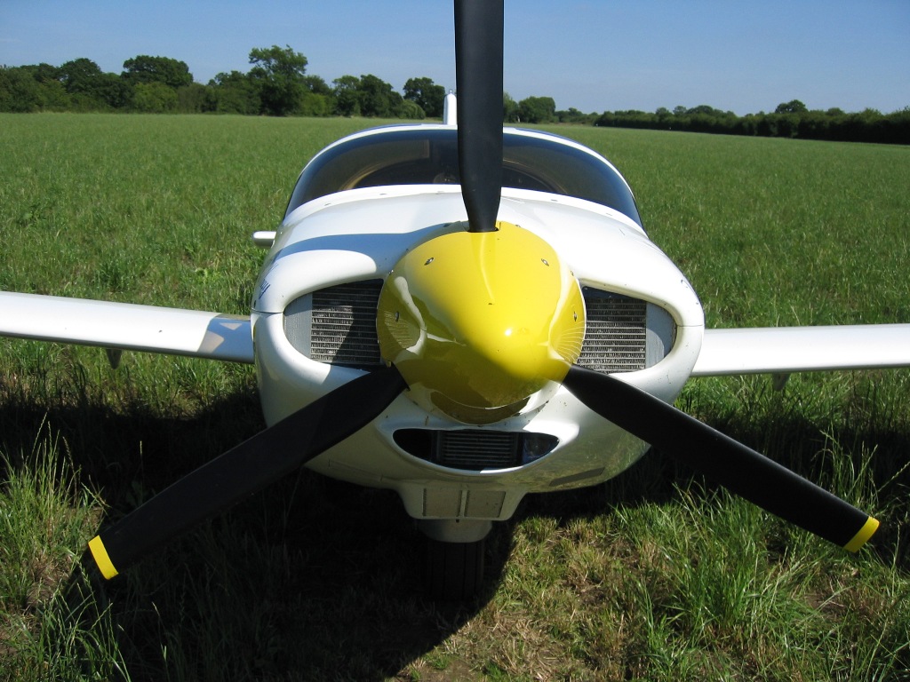

On my Classic Europa with 912UL, I am experiencing too high oil temps for comfort. Full power climb will run the oil temp to the very edge of the red zone after less than a 1000' climb, settling to well above 120 degrees C in 65% power cruise. I rarely see oil temps below 120, except in winter.
A while ago Frans made quite a convincing argument that the tandem setup of the water and oil cooler is far from optimal, ideally I should give the oil cooler a dedicated inlet.
Before going into such a substantial modification, I decided to close the gaps between engine cowl and water-cooler, as well as the gap between oil and water cooler to see what that brings in term of oil-cooling. Attached picture give you an idea of the significant gaps between cowl and water cooler.
I completed the first part of this little project: putting in a vertical plate around the water cooler. This plate blocks air from entering the cowling undisturbed, and will serve as a plate that rubber seals will be sitting against.
I was stunned to see the enormous effect this vertical plate alone has on oil temp: a drop of about 8 degrees C compared to previous flight with almost identical OAT. This time even after a 2000' full power climb, the oil temp would not exceed 130 degrees C. I am now hopeful that closing the gaps on the sides will bring the oil temps down to an acceptable level.
A long intro from my end, leading up to a couple of questions:
* What type of rubber sealing should I use, is it Silicone because of its resistance to high/low temps? And: who sells small quantities of whatever type is required?
* What relation, if any, is there between width of gap to seal and thickness of the seal?
Reasons for this question: on the propellor-side of the inlet I have a gap about 13 mm between cowl and radiator, does this ask for additional measures to prevent the seal from being pushed to the propellor-side of the radiator by the high-pressure bubble in front of the cooler? (this would open up the gap again, allowing air to escape)
* I intend to attach the seal to the inside of both halves of the cowl. Two reasons for that: (1) on the inside the seals won't disturb the airflow to the radiator, and (2) aesthetics.
What is the best way to attach them to the glass cowl (ideally without disturbing airflow by rivnuts or what else sticking out in the flow of incoming air to the rad)
* A gap exists between water and oil cooler; top and bottom gap is about 1.5-2 mm, gaps on both sides are about 5 mms. These need to be closed up as well, but until now I have not come up with a good idea for this.
How did you seal this? All suggestions are more than welcome! (with some pics if not too much trouble please)
* Finally, I need to close a 0.2-0.7mm gap between cooler and installed vertical plate. How can I best attach silicone rubber to metal, wide-head rivnuts with supporting strips or will an oversized (say 2mm) sponge-type silicone profile with adhesive-back suffice?
Note opening at top of water cooler, appr. 4 sq. inch where air can pass radiator straigh into cowl

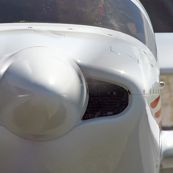

PostPosted: Tue Sep 27, 2011 11:51 pm    Post subject: Sealing the water and oil coolers in a Classic Reply with quote
Hi guys,
I did the oil cooler move below the spinner for the Rotax 912s and it has been very successful.
I control the amount of oil cooling required in winter by putting aluminum tape over the cooler.
Works a treat! Peter Kemper was the original builder to do the modification.
Also looks very stylish.
Only I can say that!

PostPosted: Wed Sep 28, 2011 12:26 am    Post subject: Sealing the water and oil coolers in a Classic Reply with quote
Attached is a picture of Peter Kember's Europa Classic.

PostPosted: Wed Sep 28, 2011 2:16 am    Post subject: Sealing the water and oil coolers in a Classic Reply with quote
For interest, looking at Peters aircraft I never made a 'mustang snout' type of arrangement when placing the oil cooler below the spinner. I used the same line as the lower cowl and set the cooler back. I will post a picture tomorrow.

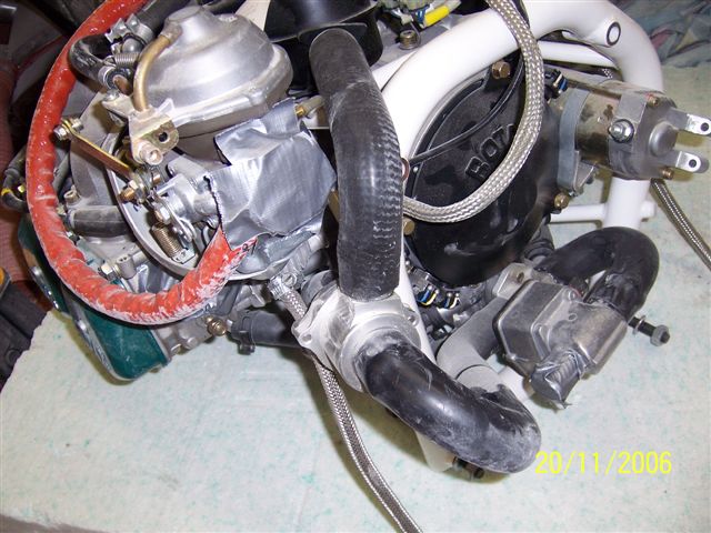

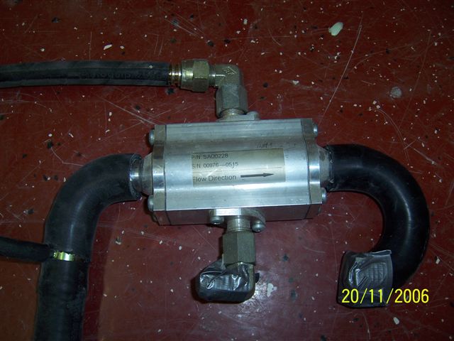

PostPosted: Wed Sep 28, 2011 11:34 am    Post subject: Sealing the water and oil coolers in a Classic Reply with quote
Hi Marcel
This is an old topic and I have repeated these
words many time:
I have had a Laminova since 2007 and +250 flight
hours and I am completely happy w it.
I am not sure about the type /size I think it is
the middle size (look at an attachment).
If I remember correct, during those days they had
only one size or so.
It works well during all OAT conditions
between -23C ... +32C which I have experienced so
far.
When cold, the oil temp follows the water temp but
a bit below and when hot, it follows the water
temp but a bit over.
Always between the limits.
When very hot, I prefer moderate climbing speed
(around 500 f/min and 100 knots) and equal power
settings to keep temps well below their limits.
During a full power cruise I have never temp
problems at all.
When very cold (= -10C or colder), I tape off let
us say 50% or more about the air-intake to the
water cooler.
Please notice I have also a water thermostat to
reach minimum temps more quick and to keep them
well over the minimums also during long and speedy
(+150 knots) iddle descendings (which I really
love).
Also, I assume when only a water-cooler and no
oil-cooler behind it, it is better for airstreams
also and for water-cooling ability.
I do not know how it works in Classic with two
water radiators? Maybe you try and let us know!
Hope this helps.
Cheers, Raimo Toivio

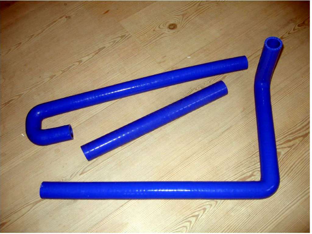

PostPosted: Fri Sep 30, 2011 7:59 am    Post subject: Sealing the water and oil coolers in a Classic Reply with quote
Europa are now offering the hoses developed by Stefan Ingemarsson SE-XRX
Contact Stefan for details
E-Mail : ingemarsson.s(at)telia.com (ingemarsson.s(at)telia.com) Tel/Fax : +46 (0)511 80160, Mobile : +46 (0)70 3780160
To give you an idea of costs
Cost in Euros at 2007 prices
Hose Description
A/C Type
No
/Cost
Classic
XS
Straight 1Meter fore engine(to cut)
C/XS
40
80
80
Bend, fore cylinder three top.
C/XS
30
30
30
Ex. bottle to radiator
XS
42
42
Pump to radiator
XS
44
44
Portside to radiator
C
60
60
Starboard to Radiator
C
51
51
Between radiators
C
19
19
Self compensating clamps, engine
C/XS
16
2.5
40
40
Delivery Europe 1-5Kg
35
35
35
315
271
Ian Rickard G-IANI XS Trigear, 300hours
Europa Club Mods Specialist
e-mail g-iani(at)ntlworld.com

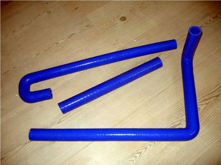

PostPosted: Fri Sep 30, 2011 9:41 am    Post subject: Sealing the water and oil coolers in a Classic Reply with quote
See picture attached. Contact Stefan for details
E-Mail : ingemarsson.s(at)telia.com Tel/Fax : +46 (0)511 80160, Mobile : +46
(0)70 3780160
 Filesize:  90.13 KB
 Viewed:  19925 Time(s)
