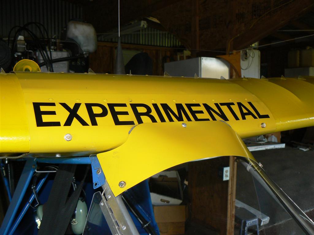

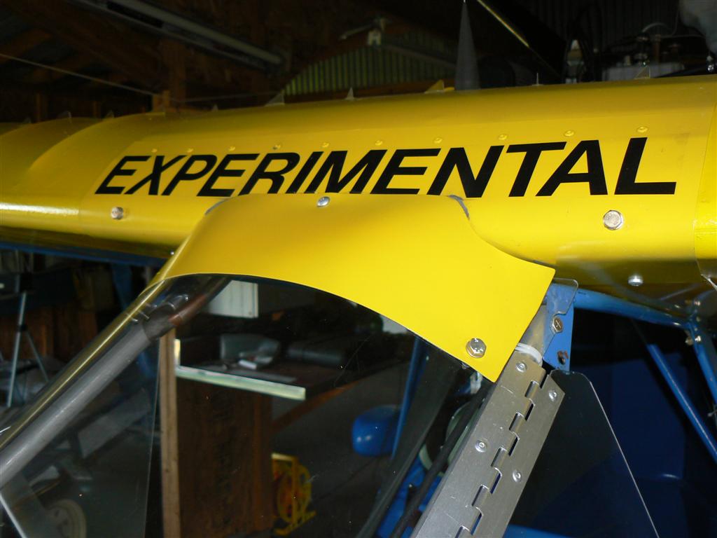

Here's how we did the FSII. Taped a piece of paper on and trimmed to shape, did it again with aluminum flashing, when that was right, made the real one out of thin aluminum sheet.
Since the MKIII windshield swings a bigger arc, not sure how it would work, or even if it would work, but for what it's worth....
