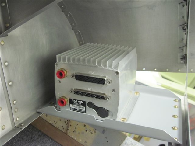

PostPosted: Sun Sep 25, 2011 6:05 am    Post subject: Re: G3X Component Locations Reply with quote
I have located the GMU using the bracket Stein provides, on the 2nd bulkhead back from the baggage, the one where the static port is close to. This puts it far enough away from the battery and the elev trim servo. There are lots flying this way with no issues. My GSU is mounted on a stiff tray I fabricated from .062 that spans the instrument panel to the sub-panel on the right as close to the right side as possible. It is extremely stiff at that location. I am installing a 3 screen system which will provide easy access to the GSU.The pitot static will go through the sub-panel using 90 deg. elbows. I would not mount it on the tunnel or close to the firewall due to possible heat issues and access.
Billc
 Filesize:  38.91 KB
 Viewed:  14292 Time(s)
Bill
WA0SYV
Aviation Partners, LLC

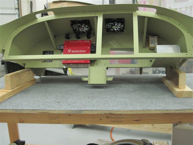

bill.peyton
Joined: 19 Sep 2010
Posts: 198
Location: St. Louis, MO
PostPosted: Sun Sep 25, 2011 6:10 am    Post subject: Re: G3X Component Locations Reply with quote
Another photo showing the locations of the remaining items

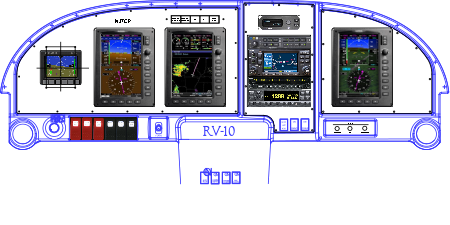

PostPosted: Thu Sep 29, 2011 5:29 am    Post subject: Re: G3X Component Locations Reply with quote
The reason I went with the 3 screen system is that both my wife and I are pilots, we use our current plane for lot's of long cross country flights. We intend to do the same with the -10. It seems like the person on the right always ends up flying for a while on long legs, so the 3rd display will take care of that. Also, our plan is to usually have the non-flying pilot take care of the radios, talking to center, looking at weather and navigating. The third display will make this a lot easier. The final reason is that my father, and building partner, just turned 87. He continues to fly and pass his medical and BFR every year. The only issue is insurance. We have been told we will not be able to get any for him without me or an instructor in the right seat. Those are the reasons for my choice of a 3 display system.
While the size of the displays are not as large as the AFS or Dynon, they fit very nicely in the panel. I attached my cad image with JPG files overlaid on the panel.
Bill
