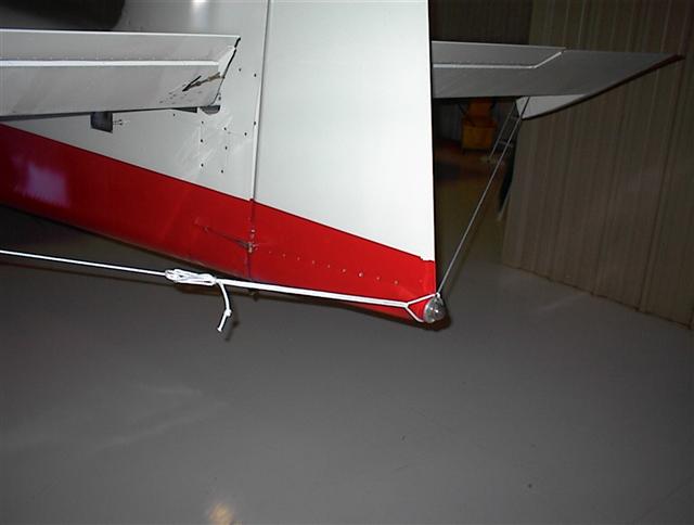

The cheap but effective way is to tie the stick back with the seat belts and then use a piece of cord to hold the rudder.

My solution is the same as Alberts. I also install an aileron lock on one or both of the ailerons, and use the interior control lock that Alex DeDominices used to sell on his ATP Products site. I am not sure where you get them now. It is a rod with a spring that fits against the pedals and the seat base, and has a velcro strap to hold the stick. Sorry I don't have a link to it any more. It is marginal by itself, but with the other systems I am using, I seem to have a pretty good system for locking the controls.

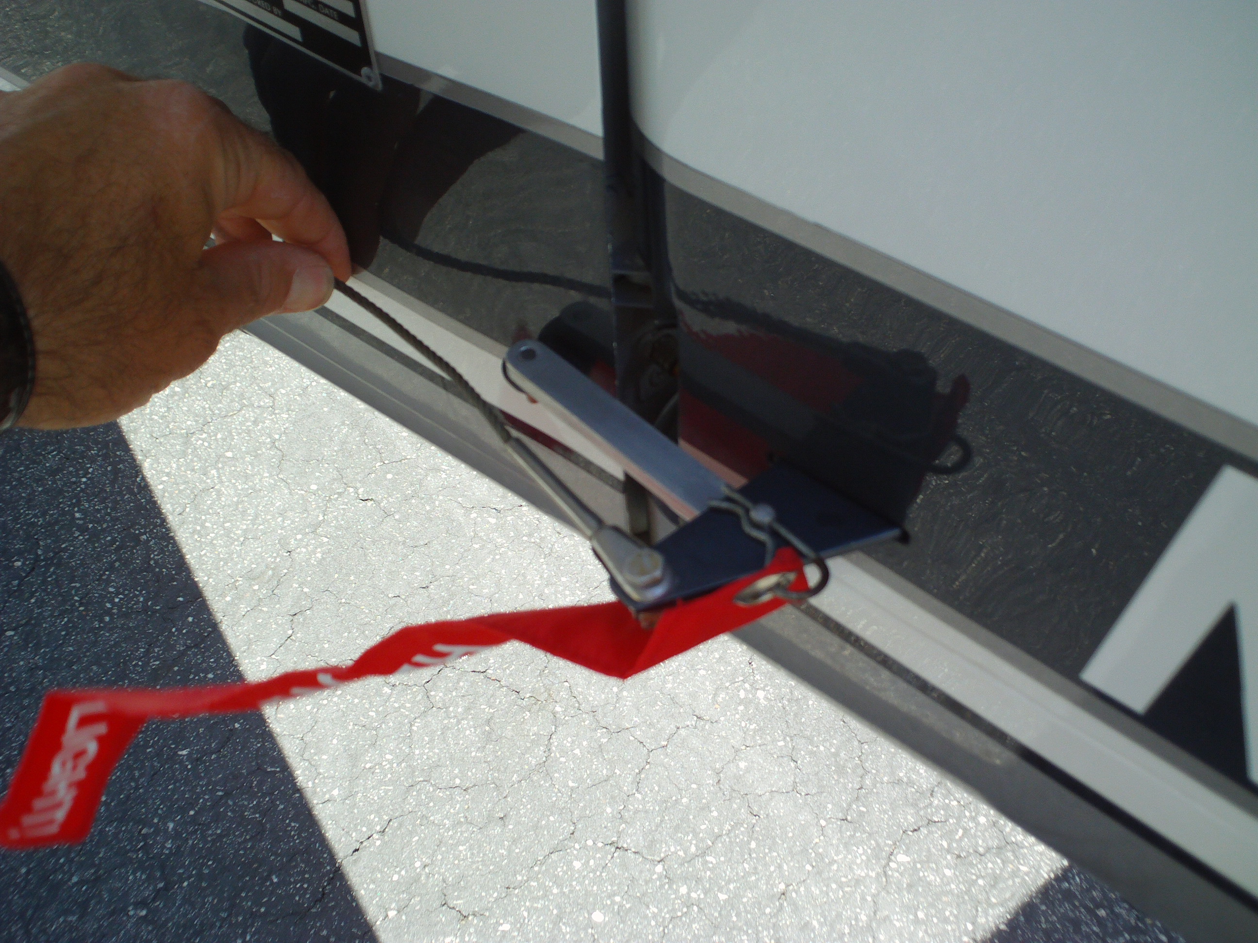

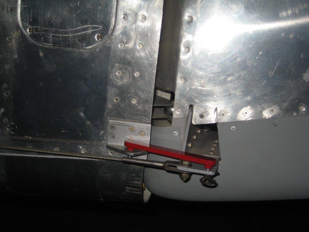

I still like my system. Seatbelt on the stick and a simple rudder lock that is ultra small & weighs nearly nothing.
(Red painted one is from my 8A)
